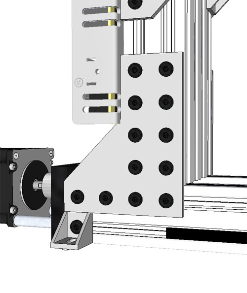

    If your build hasn't changed since the photos you posted back in April, you've got a weak spot where the column is attached to the base so tramming may have limited impact as flexure may be in control here. I would suggest cutting some extended side plates with slightly oversize holes. That will allow you the adjustment you seek and once tightened will provide a proper hold.
    If you need any additional shimming, I suggest aluminum foil tape.

    I'm talking about clockwise/counterclockwise rotation when viewing from the front of the machine. (See terrible PhotoShop art attached.)
    The X axis (horizontal in the picture) is level and square relative to the Y rails, in both the X and Y directions. There may be some pitch (rotation about X axis) on the spindle / Z axis, but what I'm concerned about at the moment is roll (rotation about the Y axis, as indicated in the image.)
    I can rotate the spindle mount clock/counterclockwise relative the the Z axis c-beam by adjusting the black router mount. What I cannot do is rotate the Z axis relative to the X axis.
    If I had used eccentric spacers on both sides of the Z, I could probably adjust those to properly align it with the carriage. But, I did not. I think I'm just going to have to make another set of plates for the Z with some slots, but I don't see that being as rigid. I was hoping someone else had already solved this. :/

  15. Rick 2.0
    2,892
    1,549
    So why not just add eccentric spacers to the upper two non eccentric wheels on the z-axis mount?
