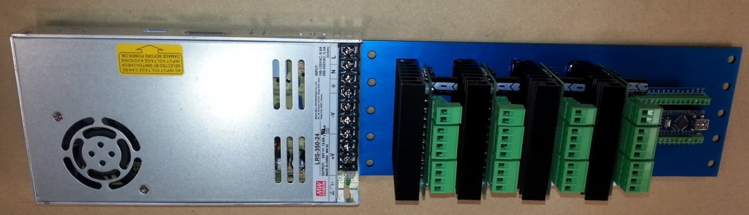

  17. Metalguru
    Metalguru Veteran
    Dec 29, 2015
    752
    547
    Not really. You need a controller (arduino), stepper drivers DQ542 or equivalent, and a power supply. Everything except the Arduino is available at the OB store. Or, if you want to spend some more money for an improved system, try the Buildbotics controller (Buildbotics Open-Source CNC Controller). There are literally thousands of ways you could go with this. Even an ESS or UCC100 and Mach3, if you wanted. All have stepper drivers and power supply in common. I use Sainsmart stepper drivers and the above power supply and arduino mounted on a panel that fits on the back of the X axis, so no cables and no separate control boxes. Just a power cord and a USB cable.
    Make sure you run 14Ga ground wires to all moving parts of the machine and base, and put fuses in your power leads to the stepper drivers.

  21. Metalguru
    Metalguru Veteran
    Dec 29, 2015
    752
    547
    I prefer the Arduino Nano and it's screw terminal shield, its a lot easier to work with than an Arduino UNO. 1/4 the size as well.
    The stepper drivers you show would work fine.
    Stepper driver power should be 16Ga wire with 5A fuses to each driver. Wire each driver individually back to the power supply, do not daisy chain the power. Wiring for the input side of the drivers to the arduino can be 22 or 24 ga, not critical.
    DO NOT connect the motor power supply DC ground to either chassis ground or Arduino ground. The Arduino (and therefore your PC) is isolated from motor power by built in optoisolators in the drivers, don't compromise this. Ground all parts of the machine (X,Y,and Z) axes and main chassis to the AC power ground on the power supply input (14ga wire) and through the AC line cord. This is important for safety, noise immunity, and draining of static charges.

  30. Jacob123
    Jacob123 New
    Jun 15, 2018
    33
    Thanks again for all the help MG.
    Would you mind sharing some more details/pictures of your wiring setup? Seems to be very clean looking ..
