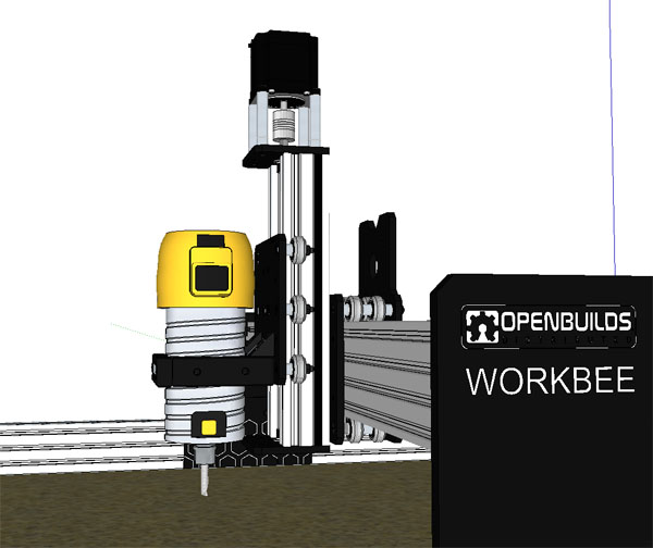

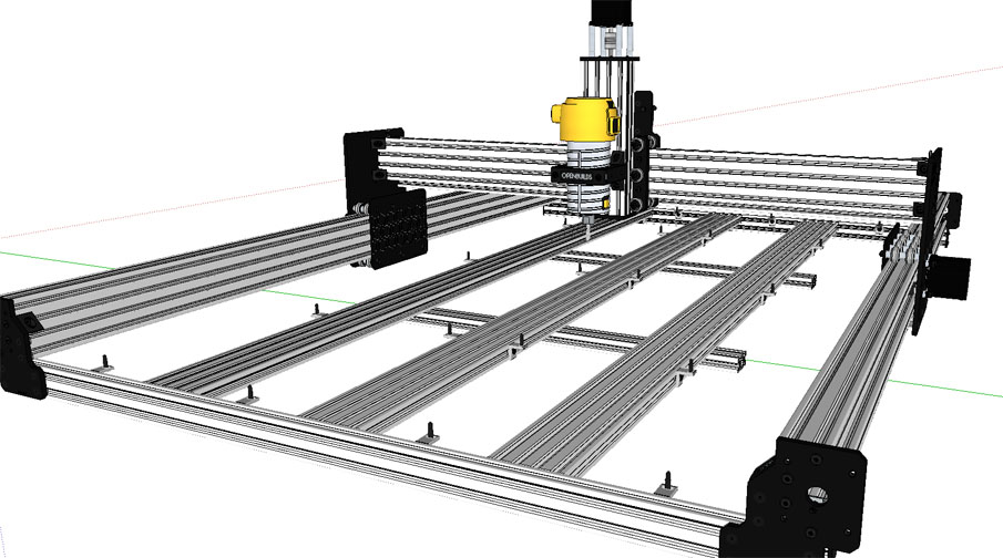

    The problem is that the bit length is eating into the 1.75". There are a couple of possible solutions here. The most beneficial would be to reverse the Z-axis. This will give you the full 1.75" to work with (2.125" if you mount the bottom axis plate flush with the bottom of the X-gantry plate). You will need to drill a few holes in the plates to make it work though.
    The other option would be dropping the bed. This is probably the easiest method and will give you about 1.7" workable assuming the bit extends half way into the working area. Note you will need to provide proper support under the bed to keep it from sagging.
    A combination of the two methods will give you even more depth, upwards of 3.74" but don't expect all of it to be usable simply because of extension limitations of the fixed rail/movable spindle method used in the reversed Z approach shown above.
