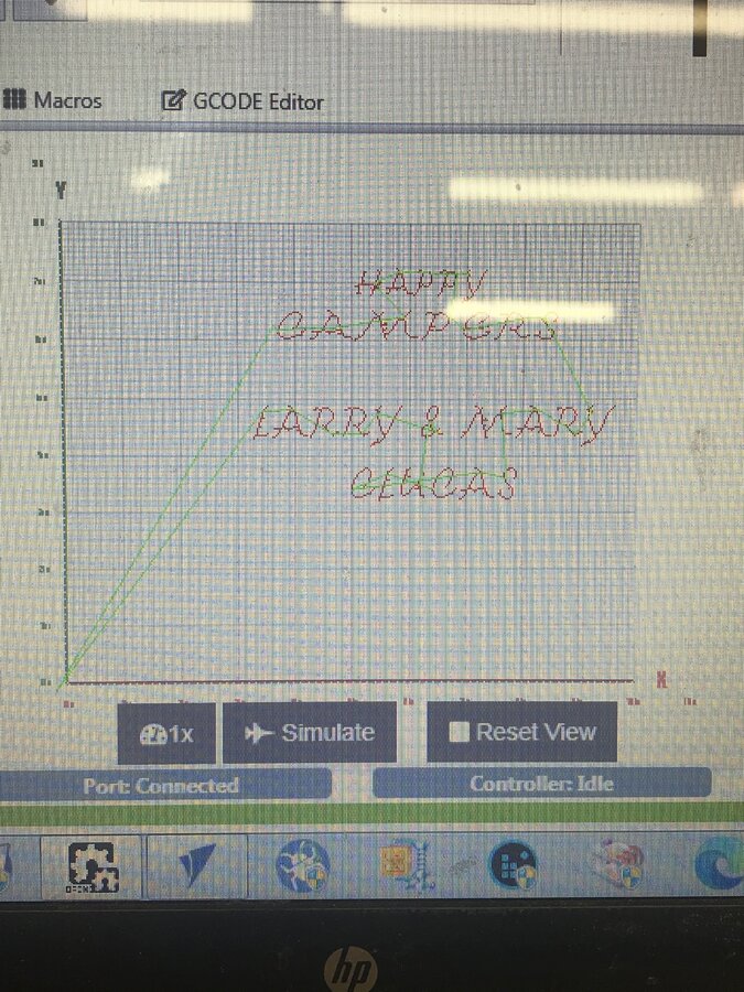

    I'm not getting the same size work page in the Openbuilds machining page as I have created in V-Carve Pro. It was working just fine that last time I needed to send a file to the CNC, but when I check the page size, its small at the machine? What am I missing?

    2,770
    1,357
    1/25? ie really small? Which post processor are you using?

    5DE18BCB-77B4-44A3-A313-E8E12C4C4812.jpeg I don’t know why the text is in the upper right, because it should be centered in the outline. But I went ahead and ran the files, and I worked out right.
    could it be because I didn’t see all of the files at the same time?
  9. Peter Van Der Walt
    14,875
    4,285
    The grid autoscales to the extent of the gcode, it doesnt know how big the stock is. Blank space to the right and top, falls outside the extent of the gcode

    Would making a box the size of the page in V-Cave, and then sending it as a profile path then represent the material size?
    mom used to using the outlines in CorelDraw with my laser to located things properly.
    The profile file wouldn’t be used for anything but location visual purposes, and would not be machined.
  11. Peter Van Der Walt
    14,875
    4,285
    Your CAM solution is used to line up and lay out the work. Gcode senders never does that function. It has no need to, gcode comes from CAM (vcarve is a CAM)
    All CONTROL does is send along the gcode to your controller
    Refer to docs openbuilds.com > software > overview
    Lining up to physical stock is done only by matching where you had the origin in CAM and setting Zero in the same spot relative in the real world.
    For example, if you CAMed off the bottom left corner, you setzero on the bottom left corner. Refer to the Hello world tutorial to learn more docs:blackbox:hello-world [OpenBuilds Documentation]
    More advanced than bottom left corner:
    If you CAMed with the origin in the center of the Work, you mark a center point in your stock, position it on the bed, jog to where you made the Mark, Zero out X and Y, then slowly zero Z
