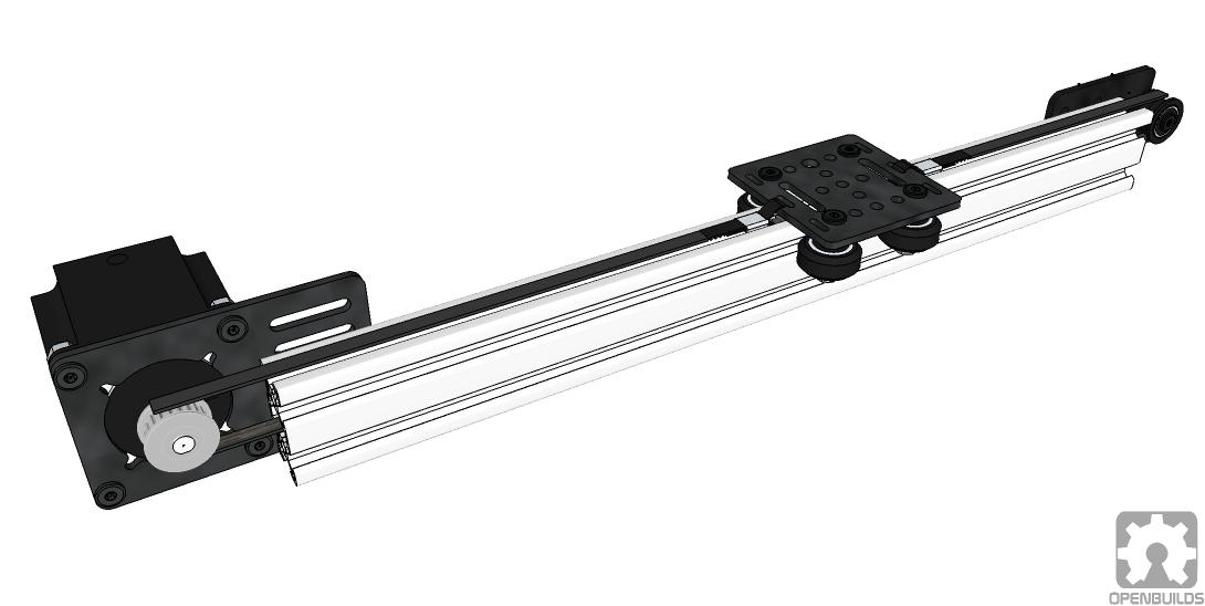

    It looks like you need to use gcode with this one.
    I guess I can use gcode to create linear motion but it may be an overkill in my scenario since I don't intend to use it to print anything.
    I was only planning to lift the object up and down to a certain distance(using belt driven actuator) and push the object to a certain distance(2 stepper motor belt and pulley setup or stationary belt 2 stepper motors just like OX CNC Machine) .
    Please see the attached sketchup - I combined the linear belt driven design of yours to fit my application.
    This way you kind of have some idea on what I am trying to achieve.

    You can write a simple stepper control program to do the simple tasks.
    Have a look here: Arduino - Stepper

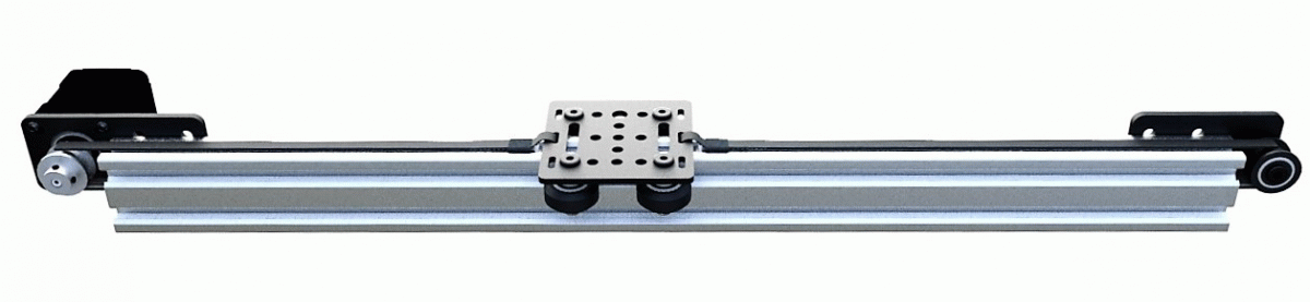

    Can i use these with G3 timing belt and pulley?
    Smooth Idler Pulley Wheel Kit
    Can I also use universal gantry plate with V-Slot™ Linear Rail 20mm x 60mm ?
    How strong are the locking t-nuts for the high torque motors nema23?
    It looks like the chain might slip underneath? Or is it pretty tight?

    Hello @finalcountdown
    Yes you can use this with no problems.
    Yes you can use the Universal Gantry plate on the 60mm V-Slot. It will also work on 20x20 - 20x40 - 20x60 and 20x80 V-Slot
    Yes you can use larger steppers with the gt3 belt however on the pulleys you may need to bore out the ID as the larger steppers will have larger shafts
