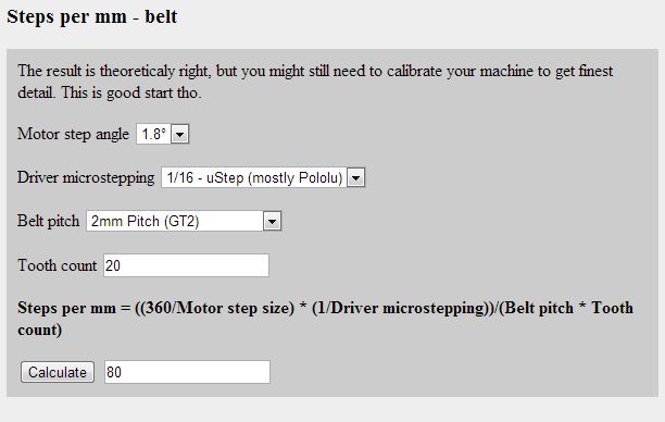

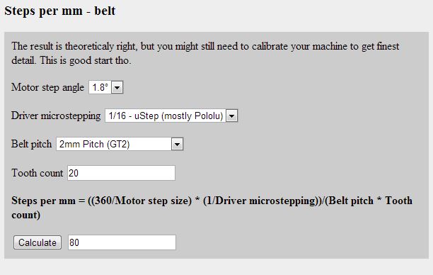

    Using the GT2 pulley with a standard 200 step motor, how do you translate this into distance movement? Per STEP.

    That really is a great resource link good find there mark
