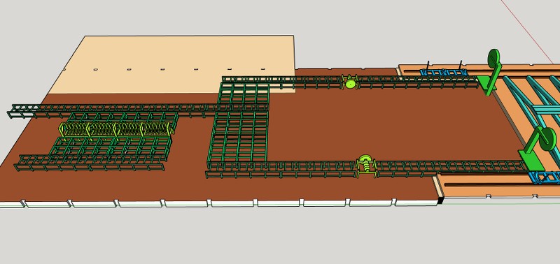

    Ah, but Alex, isn't that what we model railroader's do.

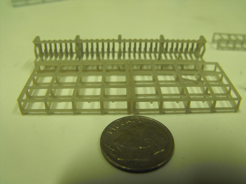

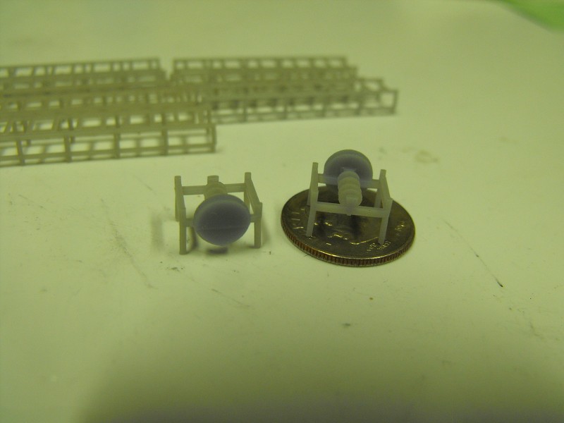

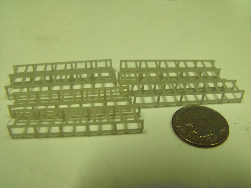

    I'm also printing all the detail parts for the mill. BTW, I model in N scale.
    And some of the printed parts

    That is an awesome model.
    I have to thank you model railroaders for posting models on thingiverse. I was building some mason bee houses out of fence boards from an old fence that got blown over by the wind. I was happy with my design but the roof lacked detail. So, I found a railroad model that had individual tile roof panels and I downloaded just those .stl files so I can do a 3d carve of those panels into wood. :thumbsup:
