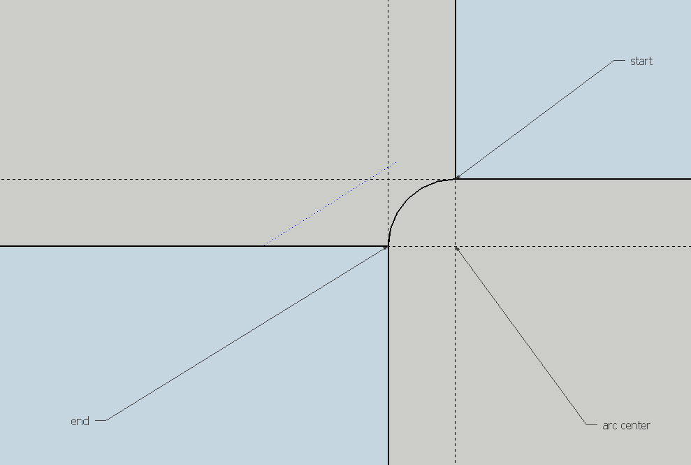

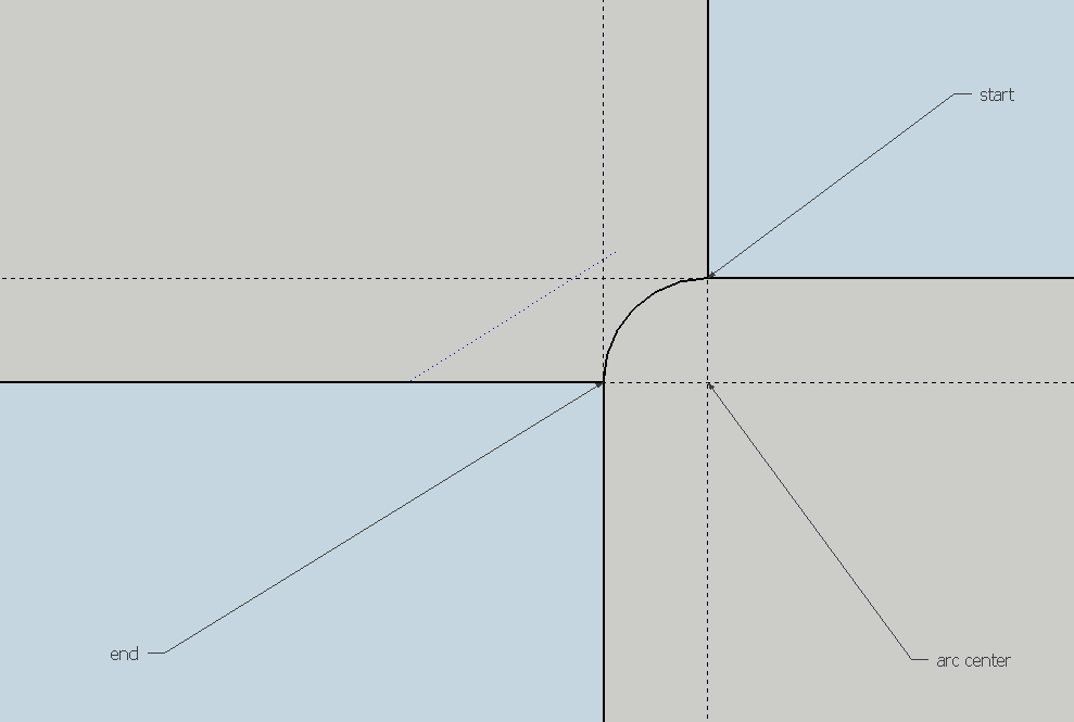

    now lets look at what the Gcode is doing
    so, tool is at X4.8625 Y3.05
    arc command says go to X4.8525 Y3.04 with a radius of 0.01", going CCW, so, starting top right and moving left and down.
    a 10 thou radius arc is SMALL, but lets check that actual arc by drawing it in Sketchup.
    all the numbers make sense and the start and end radii are equal.
    There is no doubt the actual Gcode is CORRECT.
    so that leaves us with 'something' in that version of GRBL, or USB communications error.
