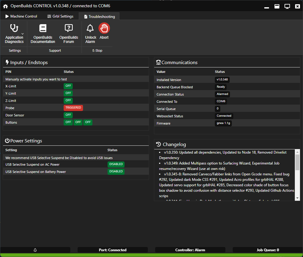

    I am using OpenBuilds Control for the sender to my Invetables Xcrave 1000 Xcontroller. I get the following error message. How do I fix this error?

    2,059
    1,448
    It thinks your probe is triggered before it even starts. Check your wiring. Use the troubleshooting tab to see if the probe is triggered or not.

    Here's a few things to try
    Go into the grbl settings tab and make sure $6 Invert Probe Pin is set to Enabled. If its not, change it to enabled, save, restart Control. Go into troubleshooting tab. Does it show the probe as being triggered? If no, you have solved the issue. If yes, contintue.
    Remove the probe wires from the x-controller. Connect control and go into the troubleshooting tab. Does it show the probe as being triggered? If yes, you have a problem. If no, continue.
    Wire black to ground and blue to probe on the x-controller. Make sure the magnet is not touching the probe plate. Connect control and to into the troubleshooting tab. Does it show the probe as being triggered? If yes, you have a problem. If no, continue.
    Attach the magnet to the router collet. In the troubleshooting tab, does it show the probe as being triggered? If so, you have a problem. Do you have a spindle instead of a router?

    Shawn, good news bad news. Good news is the $6 was disabled and I changed it to Enabled and saved it. I rebooted not only OpenBuilds Control but also my laptop. The bad news is that the bit comes down to the plate but does NOT come back up. It just keeps pushing down hard on the plate.

    You need to keep troubleshoot before actually probing.
    You want to achieve a triggered state only when the magnet makes contact with the plate (either directly or by way of magnet->collet->bit->plate). This can be tested by first touching the magnet to the plate. If that doesnt work, then STOP and check your wiring. Look for broken wires or make sure that the connectors at the plate are crimping bare wire and not insulation.
    If touching the magnet to the plate does trigger, then try attaching the magnet to the collet again. Touch the probe plate to the bit. Does it trigger? If yes, then you should be good. If no, then is your bit clean/free of build up?

    I used my volt meter and checking at the connector attached to the plate I am getting 5.00 volts. i used the black probe to black wire and red probe to the blue wire(not the magnet blue wire). In OpenBuild Trouble Shooting it shows it's Triggered(how do you un-trigger). If I touch the magnet to the plate the Triggered goes green until I remove it. Touching the collet or bit with the magnet does nothing, also touching the plate to the bit does nothing..

    No. Green means not triggered (off). Red is triggered.

    Sorry all, but I am back to my original problem. Right now the red trigger shows in troubleshooting. When I jog the bit over the hole on the plate and Confirm it's location and the click on Probe the bit moves to the center of the plate(but not touching it) and then stops with the error message in my first post. i have the black and blue wire attached to my x-controller. $6 is Enabled. When I touch the plate with the magnet the Red Triggered goes green until I remove it. The same thing happens when I touch the plate to the bit. Could it be a bad Probe??? Just about ready to say the hell with OpenBuilds and go back to Easel Pro.

    $6=1 applies to our BlackBox X32
    Set $6=0 or 1 - whatever sets it to GREEN when the Magnet doesn't touch the plate and RED when the magnet touches the plate (In Troubleshooting tab)
    Next, watch troubleshooting while clipping magnet to router - does it go RED? (Short to GND via Spindle/Router)
    If it does not go RED, lift the plate up and touch the bit - does it turn RED now? (It should) - drop plate back down (goes Green - it should)
    Don't test by running probes, test manually first

    OpenBuildsCONTROL > Grbl Settings Tab > Scroll down to $6
    Also shown in the Serial Log terminal on connect
    But do re-read my earlier reply.
    Use the TROUBLESHOOTING tab (not the setting)
    Set $6=1 - does the probe indicator on Troubleshooting tab behave correct (Green when magnet isn't touching plate, red when touching magnet to plate)
    If thats inverted, set $6=0 - does the probe indicator on Troubleshooting tab behave correct (Green when magnet isn't touching plate, red when touching magnet to plate)
    1=enabled, 0=disabled if you use the Grbl Settings tab

    Think I it. When I go to grbl settings and scroll down to $6 there no way to put in 1 or 2, the only choice is Enable or Disable. I changed it to Disabled and ran the probe 2 times and it worked perfectly!!!! Thanks for your help now I can start doing my 3D files! :):thumbsup::thumbsup:
