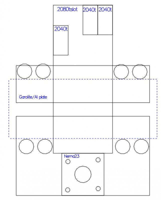

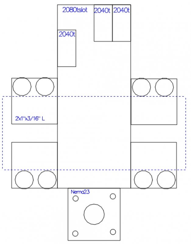

    Alternate Gantry Support
    Here is an idea for an alternate gantry, more similar to the routy than the existing garolite OX. It primarily uses 2080 uprights, with brackets to hang the bearings and stepper mount. This would seem to offer more rigidity, as well as adjust-ability and expandability vertically for different material thicknesses, the trade off being higher parts count. At least 3 versions are possible, a single flat plate with bearings and stepper mount; two plates one with bearings at bottom and stepper mount and the other with bearings on top so the bearing gap can be adjusted on the 8020 upright, or L angle brackets with bearing sets and stepper mount on each. gantrySides.jpg gantrySides2.jpg
    Does anyone see a problem with this approach?

    I am not sure about rigidity of the 2080 over just having the 1/4" Graolite plate OZ design, since I am new to CNC Routers. But is does have some resemblance to the Routy gantry plate design, so someone experienced with that may be able to better answer your question.
    I like the second design better using a single plate. This gives me an idea on how to transform the OZ into a CNC/3d printer. By allowing the plate mounted 2080 Vslot pieces to move up and down a few inches, I could raise and lower the gantry. This could be done with a simple dual screw drive or just a move and lock system. Fully retracted for CNC work and fully extended for 3d printing. Of course the Z axis would have to be extended for more travel, but would only use the first 3-4" of travel for CNC work and a full 8-10" for 3d printing. This would allow for larger Z axis 3d printing without sacrificing Z axis rigidity for CNC routing.
