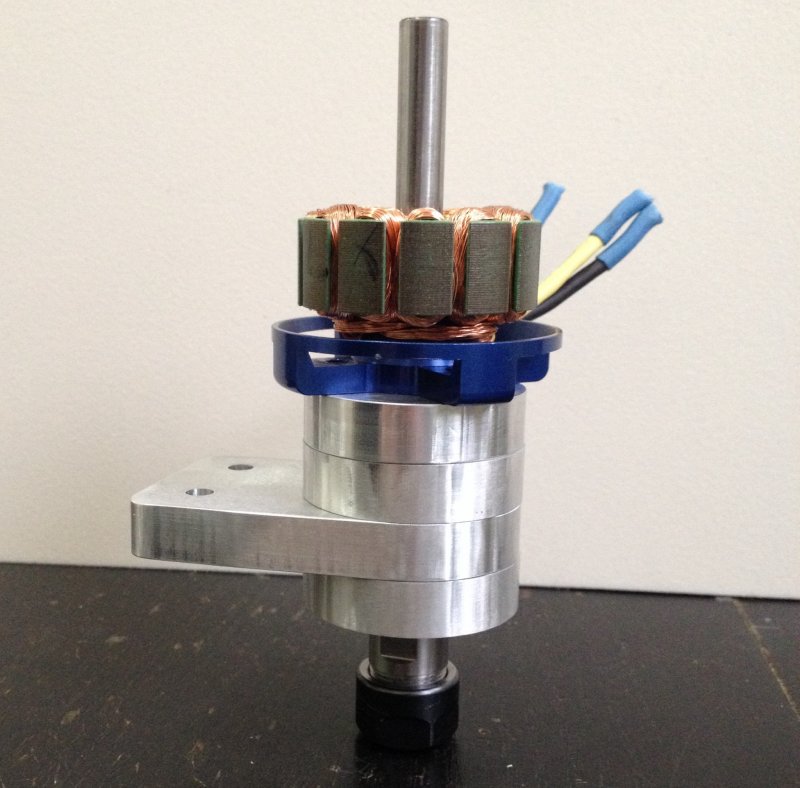

    The 20x40 for the z axis, is it open/no plate at the bottom?
    I ask cause the RC spindle I'm making will bolt to the bottom of a 20x40 with m5 screws
    Here's a pic, still putting it together

    As it is its not open but I am sure you could make it work with a little drilling :) That looks great! @Robert Hummel

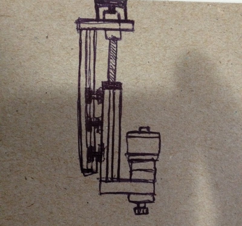

    This is kinda what I was drawing out while my mill did the cutting I think it will work out.
    As they say ya don't know till you try :)
    Please excuse the art skills lol
    Enough with the pics I'm going to spoil the build lol

    Have you thought about using the PM rotor and stator coils cannibalized from brushless RC outboard motors?
    Also, keep in mind of lateral chatter/resonance at high RPM... but I would be the last person to suggest paralysis thru analysis!

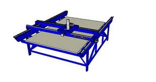

    Mark, have you looked at these from a company called ITEM.
    As everyone else here, waiting to see when the plates would be available from the parts store. Being slightly on the impatience side, I have already ordered the V-slots, other structural mounting plates and ordered six 270 oz-in Nema 23 steppers and two spindle motors (300w and 800w with E11 collets).
    I do have a question though, do you really thing a dual NEMA23 for the y is necessary? For my application I need eaqual x-y force at the spindle. I was thinking to split the two 20/60 on the gantry and two belt runs with the z installed in between-any caution from you?????

    Hi @Gopal cool videos and cool ideas. I have seen the pbc video in the past but the item one is new to me and interesting. Thanks for the share. :)
    I think that is a great idea Gopal! It could be something along the lines of the Mechmate cnc router. I like the idea and am looking forward to see how you put it to use in your V-Slot build. This is the nice thing about OpenBuilds everyone can modify and tweak until we find the best machine for the application. The way I am building it may be completely different from the next guy but we can compare results take the best of both worlds and make a new machine that is twice as good as both of the originals!
