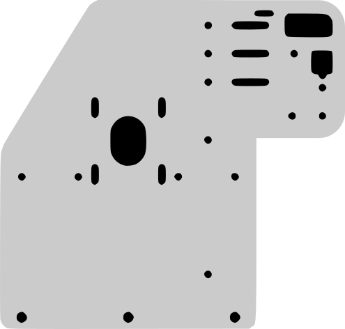

  6. Ben Hartland
    Apr 17, 2018
    Is there any particular reason why there isn't a gantry plate design that is r shaped to maximise cutting space?
    Crude mockup attached.
  7. DarkPenguin
    DarkPenguin Well-Known
    Sep 16, 2017
    201
    65
    The wobbles, I should think.
  8. Rick 2.0
    2,892
    1,549
    Because it doesn't actually add any cutting area, it merely shifts if farther back.
