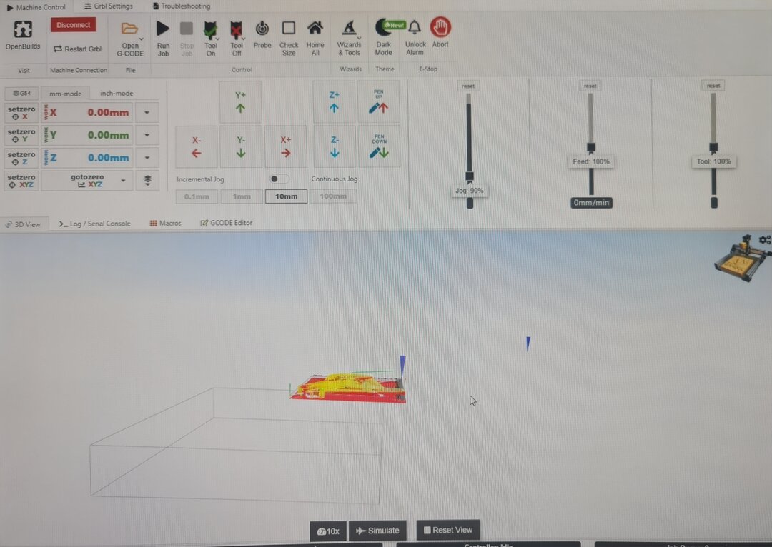

    Thanks for the reply. It was homed and all zeroed. Then pressed start and z just went straight down till the limit and got the error message.
  2. Giarc
    3,002
    1,676
    How did it go up but the picture shows a negative Z coordinate? How did you generate the G code?
    Kja0 likes this.

    Spindle moved down and should display plus not minus value?
    In fusion with the openbuilds post processor. Pretty much the same situation when taking a file from openbuidls cam.
  4. Alex Chambers
    2,769
    1,357
    The back, right, UP corner of your machine is the MAXIMUM for each axis, but is set to ZERO in the MACHINE co-ordinate system - as you move away from that corner the MACHINE co-ordinate becomes lower - that is more NEGATIVE.
    As you move Z down the coordinate will become more negative, not positive.
    The Openbuilds post processor for Fusion uses the MACHINE co-ordinate system for safety moves at the beginning and end of the job.
    When you jog your machine X +ve should move right, Y +ve should move back, and Z +ve should move up - is that the case?

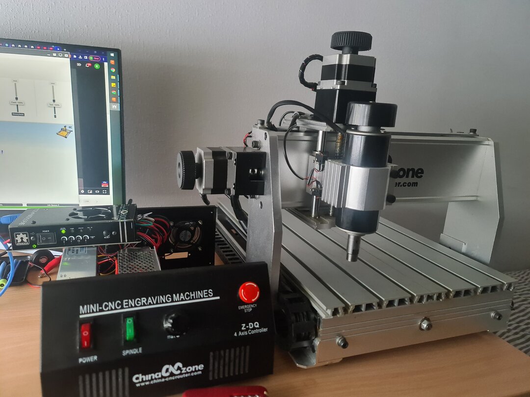

    Y was not correct. After the switch the machine homes to bottom left corner. 20230226_094716.jpg 20230226_094707.jpg
  6. Kja0
    Kja0 New
    Feb 25, 2023
    So I found that my z axis was not homing. Reflashed it and now can home it. So the machine and box in the control soft allign.
    But problem remains that the work itself is placed ontop of the box in the soft. So when the spindle tries to move that high it just hits the limit switch.
    How can I move the job in my shadow box in the control software?

    By Homing and then setting Work Zero properly.
    Work Zero and Origin in CAM must match of course. We also assume you did work through the Grbl wiki and made sure your homing, including a) jog directions and b) homing dir (which tells Grbl where the switches are) has been done correctly
    If Grbl is correctly set up, setting home, origin and work zero correctly is the job of the operator (you).

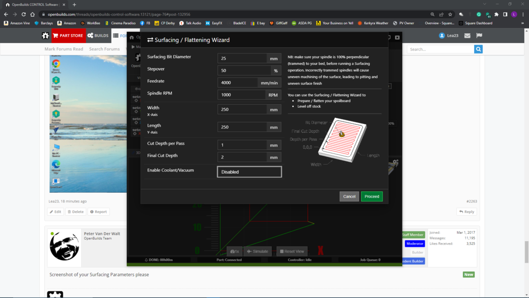

    Hi Guys,
    Updated Oenbuilds Control again today and have got another error pop-up on the surfacing wizard. See the picture attached.
    The surfacing wizard runs but fails with the router not switching off, I have to end the wizard with the OK button, any help is greatly welcome. Screenshot (2).png

    Screenshot of your Surfacing Parameters please
  16. Peter Van Der Walt
    14,867
    4,283
    The error mentions a Z-0.1 move, but none of your values in the screenshot has 0.1mm decimals? Are you sure those are the same parameters you used earlier?
    Try another round with the positive values as entered in the screenshot please. If that also errors, please provide the Gcode (gcode editor tab has a save button)

    Using your exact parameters I don't generate any double-minus gcode.
    I suspect we have different screenshots and files and things causing confusion here.
    Start fresh, use positive numbers only and it will work as designed. "Depth" is a positive value = you want to cut 2mm deep (but the machine will move to Z-Position of negative-2 for that) so don't enter any -2 or -1 etc values - and it will work. Tested again.
    If it does happen to you next time - make sure we definately have latest CONTROL (1.0.355 at the time of this reply, but do check future), screenshot of the exact parameters (not similar, exact) and sample gcode file (from that same parameter)

    Sounds like a good plan - I am unable to generate any double minus files in latest CONTROL, with any combination of positive values in the wizard.
  22. David the swarfer
    3,430
    1,907
    in .354 I am seeing --0.5 in the framing pass sections (0.5 is the pass depth), waiting for update to download....
    .355 is ok.

    All working fine now guys, thank you for the update to sort this out. Double negatives, no one needs them in their lives!!
