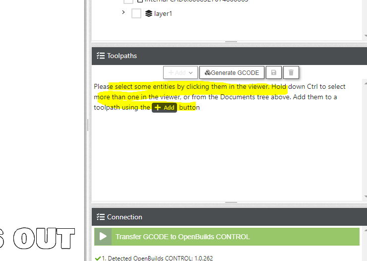

  11. Peter Van Der Walt
    14,875
    4,285
    You havent setup any Toolpaths yet:
    For example, here I set up an inside cut of the text, outside cut of rectangle. Just guessing, you know what you wanted to do with it
    If it still hangs, you didnt put in sane values into the toolpath configs :)
    Click here:
    Another example:
    Recap:
    1. Obtain CAD drawing (either from another CAD application, file on the internet, parts library inside OpenBuilds CAM, or draw using the basic CAD tools in CAM)
    2. Select relevant entities and add them to toolpaths
    3. Configure appropriate values for the toolpath (experiment, research, google)
    4. Once everything looks how you want it, Generate Gcode
    5. Send it to CONTROL to get it processed:
    See docs:software:overview [OpenBuilds Documentation]

  16. Peter Van Der Walt
    14,875
    4,285
    Checked the file, you loaded a file called ash.svg, but then nothing more, there were no Toolpaths added/created: You need to set up the job
    Note, no toolpaths created.
    I also see a weird intersection in the file that you may want to clean up in Illustrator or Inkscape first:
    #16 Peter Van Der Walt, Dec 8, 2020
  17. Peter Van Der Walt
    14,875
    4,285
    Not sure what it should be but here you go:
    Note the 3 nice toolpaths on the right - your workspace had none. You have to create those
    I assumed a 1/4" bit:
    I put a pocket for the inside to make a dish for the ash, 10mm deep
    I added two inside cuts for the slots where I assume the cigarettes can lay down in
    and finally an Outline to cut the shape out of the stock, I made that 19mm deep, for our typical 18.5mm plywood available here for example
    Attached the OBC file, you can open it from File, Open Workspace (JSON,OBC)
    Then edit to your specifics by using the Edit buttons next to the toolpaths
