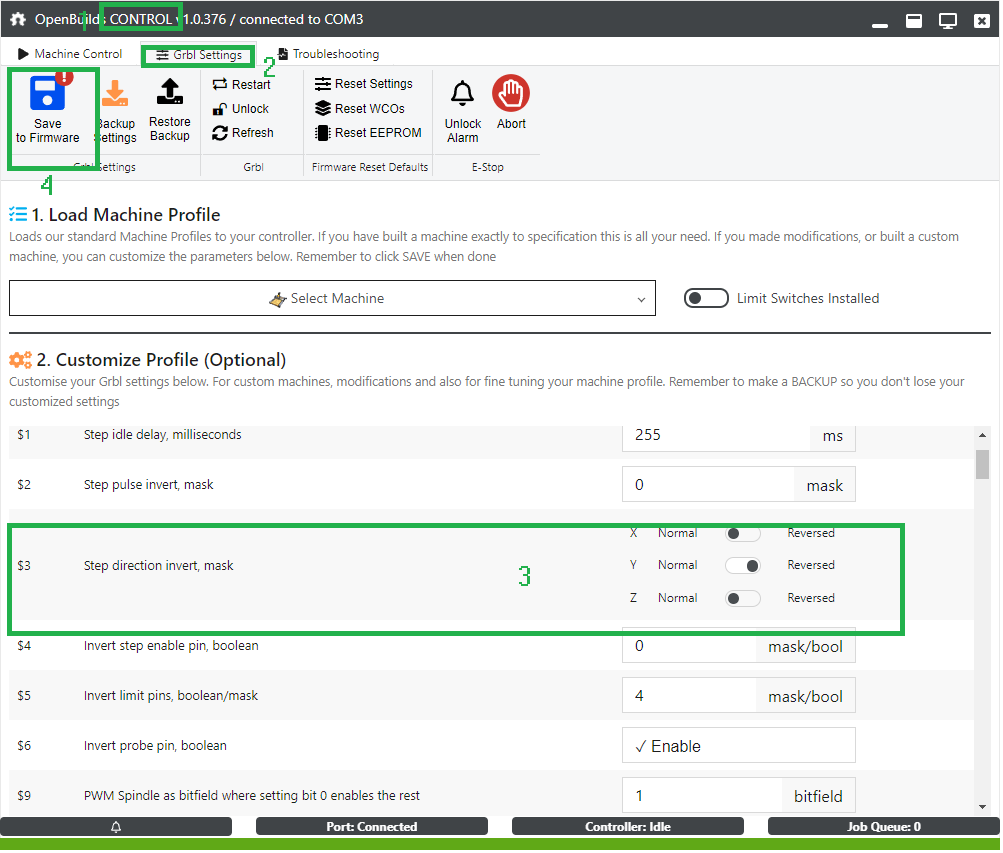

    Hi Dave, I'm new to CNC and I'm having problems with my machine. Honestly, I'm 66 years young and not that good with a computer. I tried to find how to put up a new post on the web site and I can't even do that. My machine made a hard stop and since then the 3 axis are going the wrong way and my home all is gray and won't light up. I've reset everything and even uninstalled the software and put it back and still dosen't work. If you could give me an idea of where to start to fix my issues , I would really appreciate. Thanks.

    Restore your last good backup. CONTROL > Grbl Settings tab > Restore Backup button on main toolbar > pick that backup file you saved when all was working well
    Home all being grayed out and directions being wrong (and a host of other settings you haven't noticed yet) are all Grbl Settings, so you somehow wiped your settings. Luckily thats why you have (should have) a backup
    If you forgot to backup head back to Grbl Settings tab and setup the machine as you did during intial setup, same tweaks you applied over the years, then backup so you don't have to do it again

    Thanks for the response Peter, I've brought everything back to factory default. Home all is not grey anymore but I haven't used it because the 3 axis are still going the wrong way, any advice? Thanks again

    CONTROL > Grbl Settings > $3 Direction Invert. Flio switches to opposite of what it is now for any axis going wrong. Assuming all the other settings are correct

    Hi Peter, I'm very sorry that I don't understand what to do. All I did with this machine is do a boit of letter engraving on wood. I am not at all familiar with the language. I have never done any tweaks on my machine because I only knew the basics. I don't know if it's possible (for a fee of course) that you could access my computer and help me fix this?

    Exactly that, step by step. Open CONTROL. Go to Grbl Settings tab > Scroll down to $3 Direction Invert. Flip switches as needed to fix any axes thats moving incorrectly.

    Thank you so much, I finally understood, I got to home all, now I'll try it out. Thanks a million.
