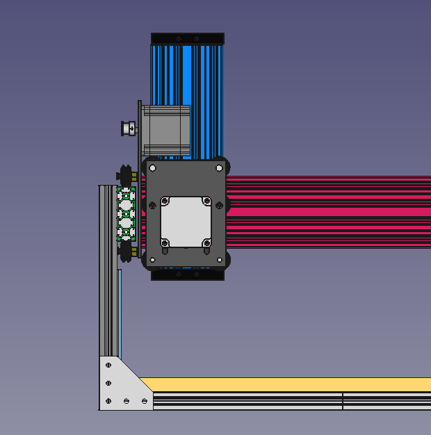

    The X and Y are at the same level, in a squared shape, therefore supporting each other bringing resistance against the piece to be milled, improving the rigidity of the structure. That has its cons, because it rises the center of mass of the CNC.
    [​IMG] (Side view)
    This is a side view of the X-rail. As you may see, the pinion-belt system is hidden in the C-Beam. It lets me save vertical space, so X and Y plates can be extremely close.

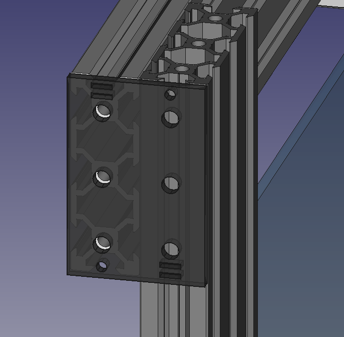

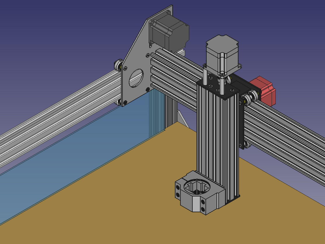

    X-Plate.
    That was challenging, I wanted a really small, yet strong structure, it will hold the Z-axis, the X-motion system, both NEMA and a spindle. So much things in a small place.
    The C-Beam is a great deal for X-axis, I don't need double V-slot and there is enough space inside for the rpinion-belt system and the wiring.
    Still WIP, but, any hint, idea, critic, sugest, or any thought are welcome.

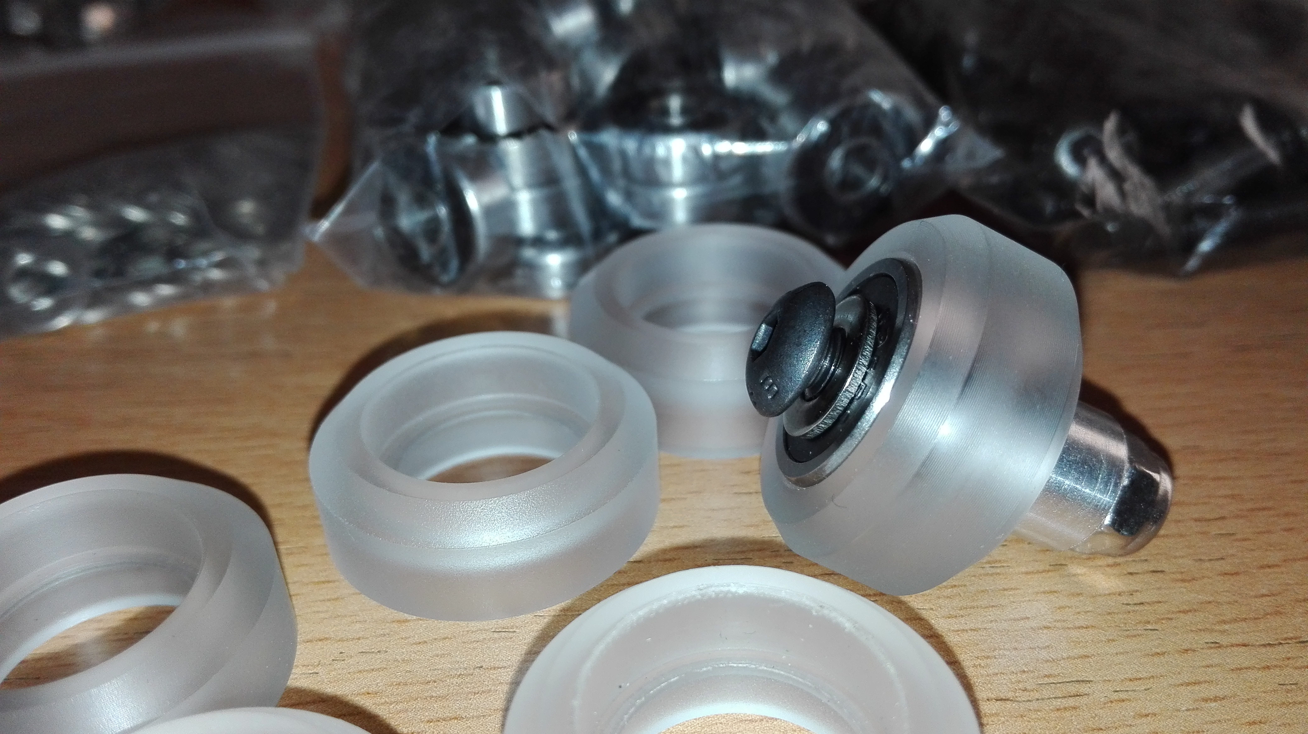

    The only thing I would question so far is driving the Y-axis from only one side. It will be difficult to keep square. Other than that this seems like a real good start. You will want to use the solid V-wheels rather than the ones you have shown where they contact with belts as the belt won't ride properly on the regular V-wheels.

    I think you will need two steppers for the y-axis. One on each side.

    You are right. Definitely, there will be a dual NEMA23, I will simply clone the right plate on the left :)
    That's because I'm lazy :D I designed the Wheel kit with V, but soon I realized about it. I ordered PC solid wheels ;)
