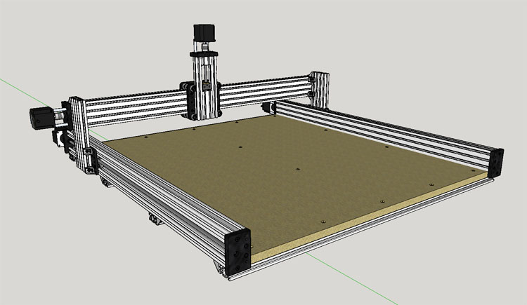

    Is their a build that will cost me less than 700 dollars(I have a router and 3 stepper motors with controller etc) that will give me 750mmx750mm cutting area? and if so, please let me know. Ill need a parts list because I am honestly a complete noob.
    I look at all these greate builds, but I hate to guess about what the parts are by the pictures. I just do not know where to start. I already have 3x 1500x20x40mm rails, 1 20x20 rail, and assorted 20mm 80/20 pieces. I just need a good guide here to help

    Based on not needing substantial Z axis depth this will be fairly simple to build. C-beam rails with screw drive using the rail pieces you already have to support a fixed bed. Will sketch up something later this evening to give you an idea what I'm thinking. No custom plates required and it'll blow the socks off a shapeoko.
    The only issue I see at the moment would be needing a (small) 4th axis motor and driver. Will the BOB you have accept a 4th axis?

    Anyway, attached is a quick Sketchup model and a prelim parts list. Please excuse the quality of the model. I'm away from home and my main computer and all I have to work with is a laptop and 3DWarehouse parts downloads so the results aren't pretty. The Z-axis is incorrect as shown but too much effort to fix on a laptop. It will need to be much simpler to bring this in on budget. Connections are also not shown. Cutting area is approx. 750 x 840.
    The parts list covers the majority of it but not down to the level of a final bolt count. You can see though that the $700 budget is fairly workable.

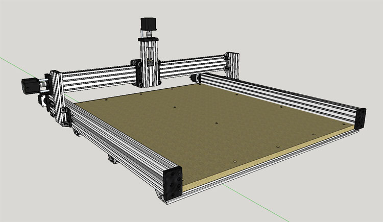

    Revised model attached. It's a fairly straightforward build. Look it over and see what you think. Cutting area is approx 780mm x 830mm and will allow full depth cuts up to 1 1/2". You will need to cut the block supporting the Z-axis nut. Delrin would probably be best but a hard wood block would be acceptable. The duplicate of the Z-axis rail setting off to the side shows the connections between the members. (Look down from the top.) You will need to drill some 4mm access holes through the sides of the outer members to tighten the screws but this is fairly simple. One of the stringers underneath will need to be spliced from the offcuts of the 1500mm 20x40s you have since you only have 3 sticks. For the router attachment, a good and economical system can be found here.
    Will review the parts list later this evening. Do you intend to install cable support chain?

    I have attached an image, maybe I missed something on the Z axis. My question, is the block that I circled attached to the plate behind it? making the full gantry move up and down? if so, am I drilling holes to make it fit? if not, how am I attaching the z axis. I noticed it is set on the rollers, thats why I assumed the little block that I have to make is going to attach to the gantry plate. other than that, it is pretty straight forward, and thank you very much for helping me with the build!

    Yes, the block is attached to the gantry plate and the the gold nut sets down inside it and is fixed with a setscrew. The block is attached to the gantry plate from the backside where there are recessed screw holes already cut into the plate as this is designed into the plate as an optional location for nut blocks. If you use Delrin for the block, drill the mounting holes 3/16 and the 5mm screws will self thread, providing an adequate connection. The block can also be attached from the front side but you will need to drill some holes on through the doubled gantry plate if you intend to do it that way (which may be necessary if you use a hardwood block as nuts would be required which would interfere with the router mounts if installed at the front). A 3D printed block would also be a possibility as the nuts could easily be recessed.

    Shopping cart attached. Fairly certain I got it all but no guarantees. You will need to add a DQ542MA Stepper Motor Driver and 2 Double Tee Nut™ because of your situation. You will also need a Delrin block approx. 20mm x 35mm x 21.5mm. The average reader will need a 150mm length of TR8*2 lead screw and nut. Spoil board is 34-1/16" x 39-3/8".
    Specific quantities on the screws are:
    88 M5x8
    4 M5x10
    40 M5x20
    34 M5x25
    12 M5x55
    4 M5x60
