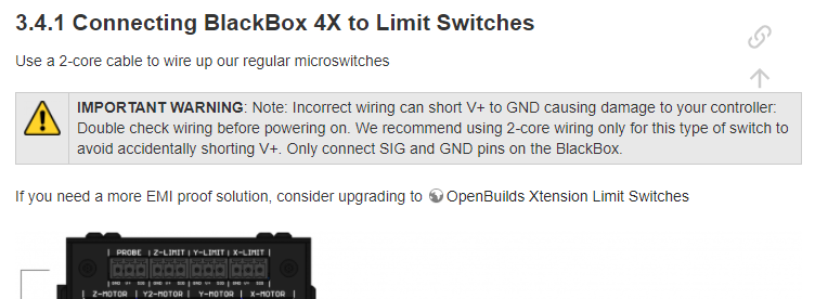

    I've had a problem installing the blackbox to an older CNC a friend had, we got the motors working, but he connected the wires for a micro switch on Ground and V+... resulting in the blackbox not responding anymore and motors will not be powered or moving anymore. Do we have to ask for a replacement board for the black box or there is a relay i can look at to get it going? maybe a capacitor?
    I must have created a short adding the v+ power to the rest of the circuit.
    I'm trying to trouble shoot but now, the computer won't connect to the blackbox when before we hit the limit switches, all was working flawlessly.
    Thanks,
  11. Peter Van Der Walt
    14,866
    4,283
    While I am truly sorry to hear about your unfortunate accident, unfortunately there is a big warning on docs:blackbox:connect-micro-limit [OpenBuilds Documentation] against exactly that: - you can ask [email protected] if they might be willing to sell you a replacement Brains Board only (cheaper than a complete BlackBox) but very NB do recheck all wiring before powering on any time you work on wiring.
    Shorting out the power rails typically results in unrepairable damage.

    I know exactly That! Still, we need to get it working so, i'll have to order a new brain yes.
