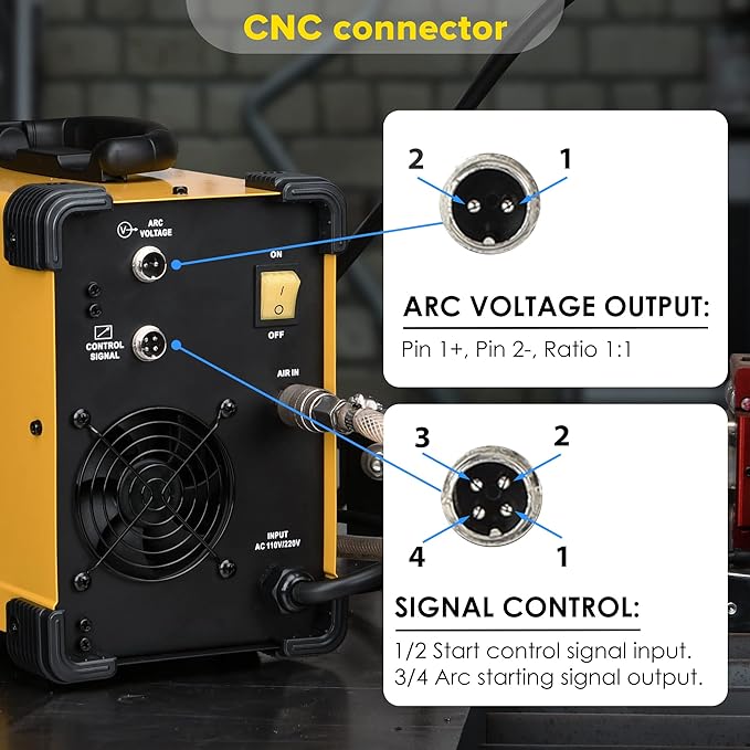

    Thanks for releasing this guys. This is absolutely amazing. I bought the plasma torch for my Hynade CUT60DN. In your video you said it came with the attachment to plugin to the relay socket. I don't have that. Does anyone know how it needs to be wired? The leads in to the relay socket only have two connection points. However the wiring diagram for the signal control has 4 connections. How should this be wired up? I really feel like I'm missing something obvious. Does the relay control need to talk to both the start control signal in put and the arc starting signal output? or do we just ignore the arc starting signal output?
    On a separate but related note, does this build need the touch off switch? The one from these docs, docs:blackbox-x32:connect-plasma [OpenBuilds Documentation].

    Switch is used for touchoff on a floating head. So technically yes you do need it. Watch the LEAD 1010 plasma assembly videos to see the floating head and where it goes etc as well as how it touches off between sections of the cut.
    Wire pins 1 & 2 to relay
