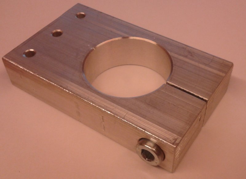

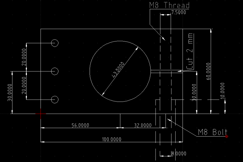

Kress spindle mount for OX / V-slot DXF
A mount for the Kress spindle

    Nice job! Thank you for sharing oni305
    p.s. Do you happen to have the model file or dxf to share?

    I'll upload the DXF today ^^
