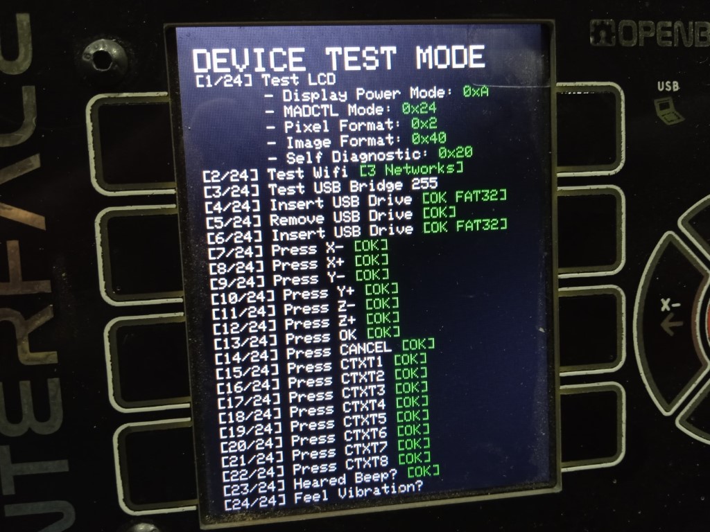

    Why do touch buttons on my new iInterface go completely crazy.? Either they respond before I touch them or they overreact by activating other buttons.
    Joseph_binary likes this.
    14,867
    4,283
    Usually EMI in the environment around it.
    Take it away from your workshop.
    Make sure you are on Firmware v1.51.
    Power it up using a USB cable.
    During the Boot process, when the big logo appears on screen, press and hold the MODE button on the left side until you hear a beep. This is a device test mode where you can test it just like the factory does.
    NB make sure you are on Firmware v1.51 first as thats the version we added the Mode button code described above to allow customers to also run the Device Test. docs:interface:firmware-update-control [OpenBuilds Documentation]
    Taking it away from your workshop for this test tells you if a nearby spindle, faulty earthing, fluorescent lights, etc in the workshop is causing interference: docs:blackbox:faq-emi [OpenBuilds Documentation]
    If it tests out fine away from the shop, we know the hardware is good. If you fail the test, contact the store via Support and they will be happy to get a new one out to you

    I have now grounded the frame on my cnc and it helped when I go a little away from power sources. And then I ordered ferrite clamps.
    But when I mount it on the magnet holder, it goes crazy. Could it be because it is not the original magnet the store sells.?
    14,867
    4,283
    I almost doubt it directly related - but what if you take the magnet and hand-hold it against the back, but move away from the machine? Does that make a difference? (May be conducting some interference from the frame to the Interface via the mount?)
    That said, we'd really still like to make sure the hardware is good by performing that test above ^ :) - before we start chasing interference issues: What if it is the hardware and we could have had the store send out a new one already. Please first try that - away from the shop - it will give us the confidence that a) the hardware is good (or bad) and then b) yes we have to try to find interference.
    You can repeat the QA test with the magnet on the back too - away from the shop - just to cement any observations.

    I have done the test and it works. And it works after I grounded the cnc away from the magnet. As soon as I mount the magnet away from the cnc, it goes crazy.
    But I will test it with the magnet in a other room like I did without.
    The magnet is very powerful.

    Only when Interface is connected to cnc there are problems.
    And that's only when I or something touches the plate with the red arrow, even though I'm standing as far away as possible. If I or something touches all that around with green arrow, there are no problems.
    So how do I get the plate grounded.?
    The table on which the magnet is mounted is grounded.
  14. Peter Van Der Walt
    14,867
    4,283
    So, long story short, something from the machine frame is conducting some EMI to it.
    Mount the magnet to the table, a shelf, or something else non-conductive - not on the machine itself. What machine is it? Running a VFD?
    We could send a replacement, but as you confirmed the test away from that area is perfect. You will need to address whatever is the source of interference in that area. We had seen one guy who had a chaffed through electrical cable in his garage floor that conducted up his body if he stood on the floor, went away if he sat on a plastic chair. Another guy's subpanel didn't have an earth so all the electrical devices were not earthed. Then of course Chinese VFDs are a good known source of interference too. Tell us whats around

  18. Joseph_binary
    Feb 17, 2019
    So, what if we update everything, run the MODE test and get stuck at X- / X+ test.
    Something is wrong with the way the touch is interpreted. -Any suggestions for troubleshooting and/or fixing that?
