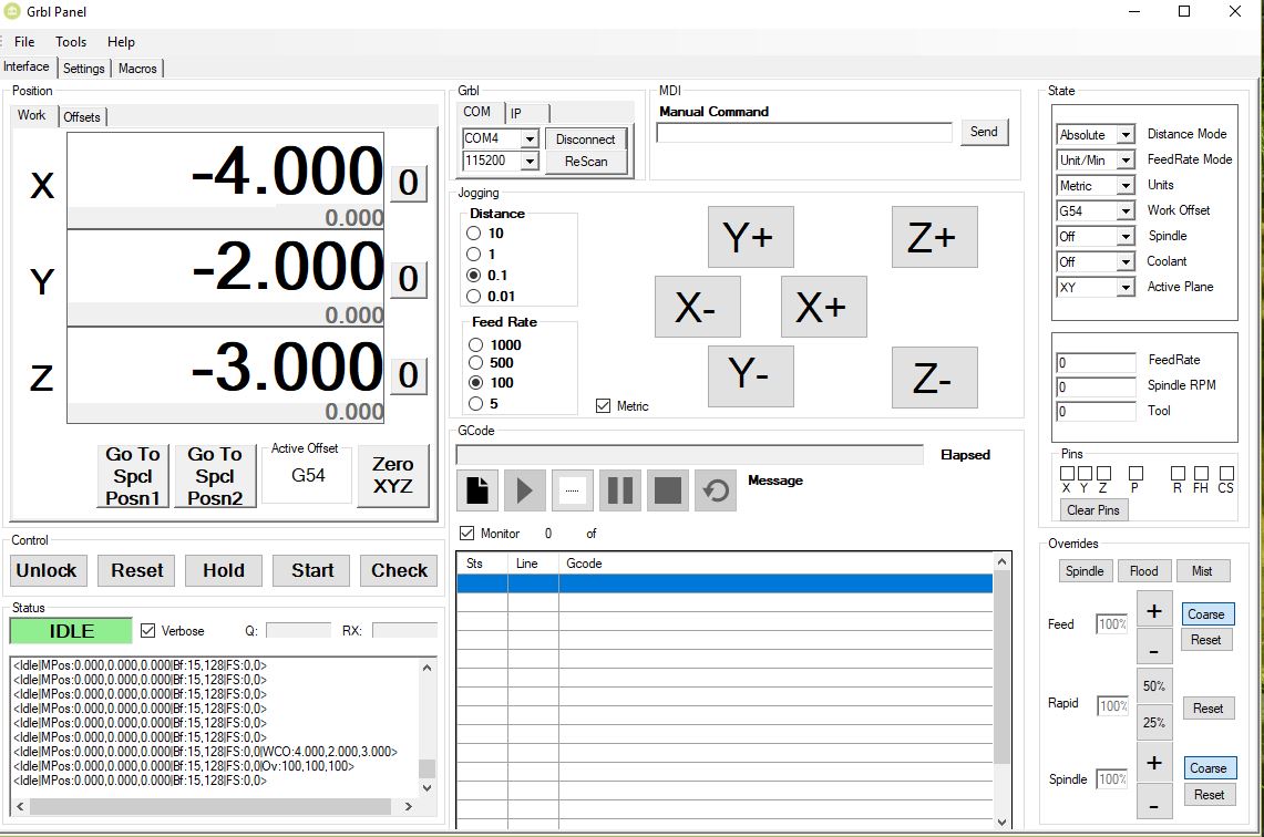

  3. Cabinetguy
    Sep 23, 2015
    Hi Mark!
    I'm relatively new to the CNC world and finished assembling my C-beam machine last week. I got it working fine by following your 2 hour tutorial and was able to successfully cutout a couple of items I designed in Sketchup.
    The problems started when I installed my limit switches and tried to do a home cycle. The initial tutorial said that the software considers the front, left corner as the zero xyz point. When I enabled homing, it runs all motors in their positive direction which lands the router in the back right corner with the router up as high as it can go. When I tried to run those same files again, the alarm went off immediately as the machine hit its X limit immediately. Apparently the machine didn't get the memo that our new homing direction was the opposite corner. Any ideas on how to fix this?

    You need to change the $23 setting in GRBL.
    https://github.com/grbl/grbl/wiki/Configuring-Grbl-v0.9
    I am configured in the same way as you are, and have $23=3, which sets the homing travel for x and y in the opposite direction. $23=7 will reverse x, y, and z.
    -- John
  5. Cabinetguy
    Sep 23, 2015
    Thanks John! That worked and now it is homing in the right direction. I have tried to zero out that location so when I run programs it will consider that as the start point. Now when I do the homing cycle it comes up with coordinates of x= -269, y= -269 and z= -79. I have performed the zero xyz cycle several times and disconnected and reconnected and when I run the home cycle again I get the same negative numbers. I'm getting closer! Any idea how to permanently set this as zero xyz?

    So what happens after homing if you hit the zero xyz button?
