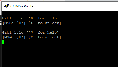

  17. Bruce Wang
    May 16, 2020
    Here you are. (Sorry, I had misunderstood previously.)
  18. Peter Van Der Walt
    14,868
    4,283
    Hmm, that's weird, that's all we check for;
    1) We open the port OpenBuilds/OpenBuilds-CONTROL
    2) We rely on the autoreset to make Grbl send "Grbl x.x[az-]..." (we check for it here OpenBuilds/OpenBuilds-CONTROL)
    3) if after a second autoreset didn't work (boards without DTR/Autoreset) we send Ctrl+X to make any listening Grbl instance reset itself (OpenBuilds/OpenBuilds-CONTROL) and wait again for the string "Grbl..." from 2) above
    4) If after 2 seconds we still did not see a ""Grbl x.x[az-]..." string, we send the word "version" to see if any instance of Smoothieware is on the other end (not supported anymore, but first couple version of control could talk to Smoothie), we wait for the Smoothie version response: OpenBuilds/OpenBuilds-CONTROL
    5) If Smoothie also does not answer, we close the port OpenBuilds/OpenBuilds-CONTROL
    As you have both on hand, stopwatch the responses in Putty, see if the GrblMega stuff is a lot slower to respond maybe? The timing works with official Gnea Grbl-Mega, and Gnea Grbl (328p) but community forks kinda does become a "well why are they doing xyz differently from upstream"
