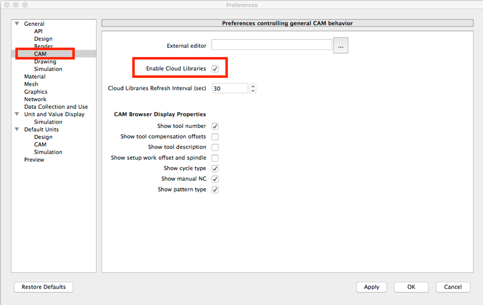

    -First, make sure you have cloud libraries enabled in your preferences.

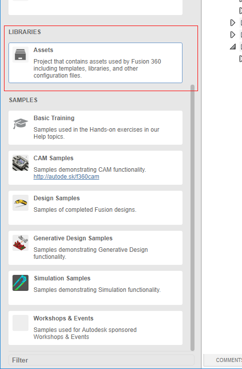

    -Open Fusion360 and open your Assets library.
    -Open the CAMPosts folder.

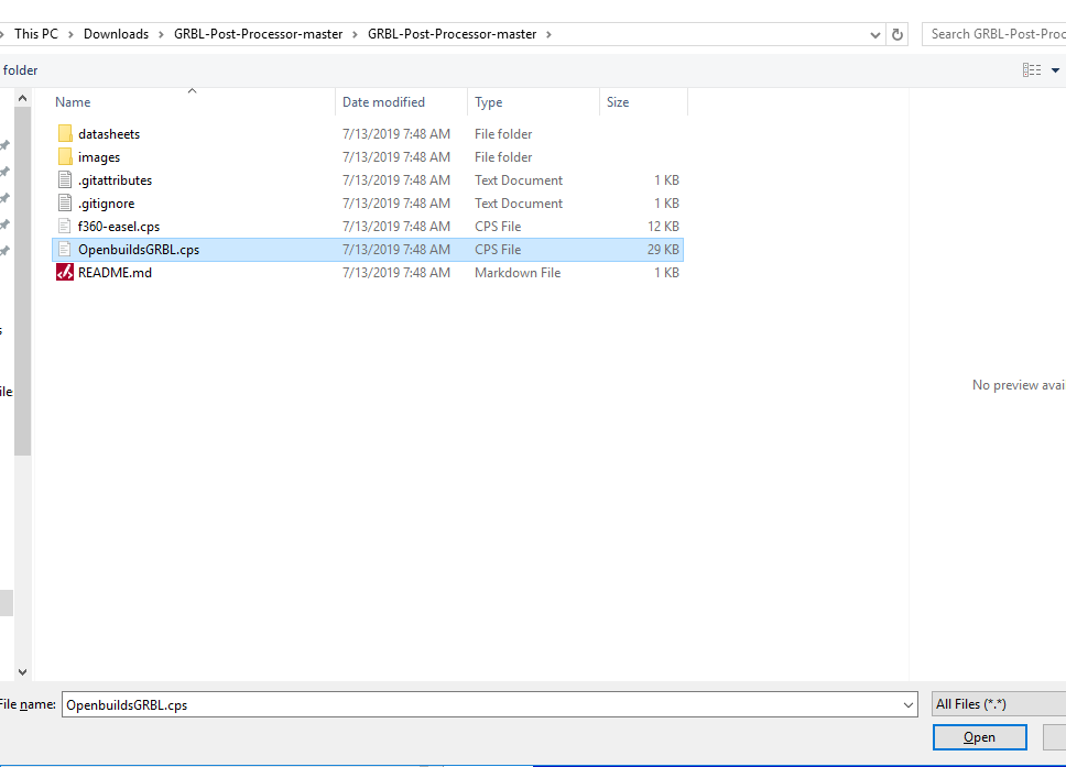

    -Click on Upload
    -Click Select
    -Navigate to the extracted folder and select OpenbuildsGRBL.cps
    -Click Upload

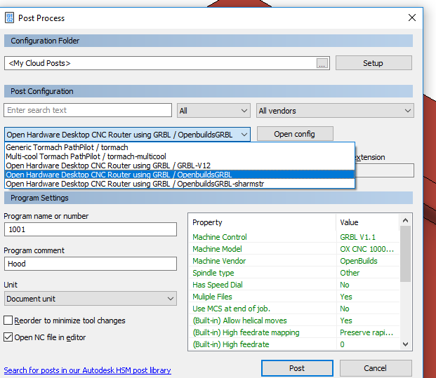

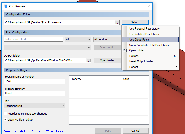

    To use this processor:
    -Click Post Process.
    -In the Post Process dialog box, click the Setup button.
    -Select "Use Cloud Posts".
    -Select "OpenbuildsGRBL" in the dropdown next to the Open config button.

    Im trying to install this and i do not have an assets area..

    Thanks for preparing these instructions, Shawn! The Preference setting to Enable Cloud Libraries was not enabled by default on my copy of Fusion 360 version 2.0.7046 (Personal). Maybe if a check for this was inserted as the first step in the instructions it would help others who might get stuck on this (like me!) before seeing this post.
