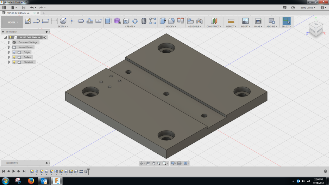

    Any ideas why it won't thread this hole?
  6. Joe Santarsiero
    Joe Santarsiero OB addict
    Oct 30, 2014
    902
    196
    Does it run into the front hole? It might not like that. Uncheck full length and try a depth to see if this is the case.

    Need more assistance guys I Looked for tutorials on moving the group of 4 small threaded holes and also copying to the other.
    side.
    Thanks very much in advanced
  9. Joe Santarsiero
    Oct 30, 2014
    902
    196
    I could tell you how to do this off the top of my head for SW, but not fusion. I'll try though.
    To move the existing hole pattern you just find and edit the sketch of the holes. To make a pattern on the same plane you can either pattern the holes in the sketch or pattern the feature out of sketch. To duplicate everything on the bottom of the part you select extrude cut, select the same sketch again, select extrude from, and choose the bottom surface.

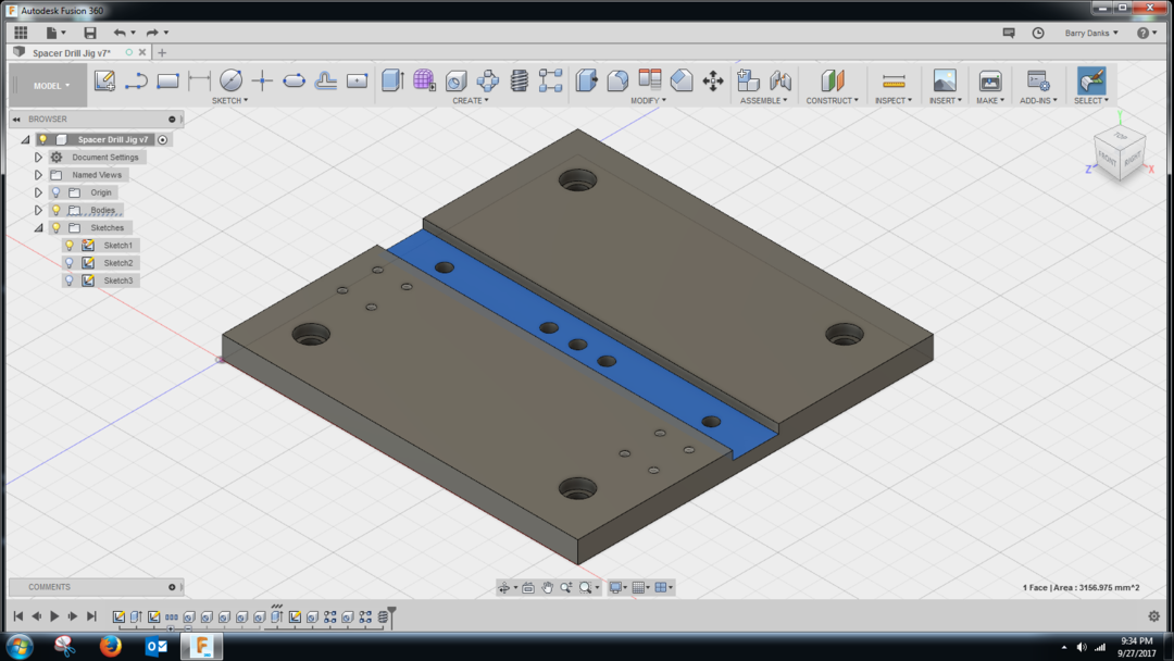

    Any ideas how to make this slot wider?
  15. Joe Santarsiero
    Oct 30, 2014
    902
    196
    Find the sketch or feature that made it that wide Barry! You need to have more confidence in yourself sir. lol
