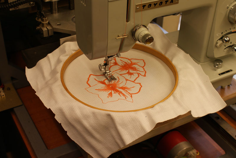

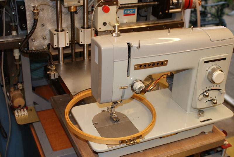

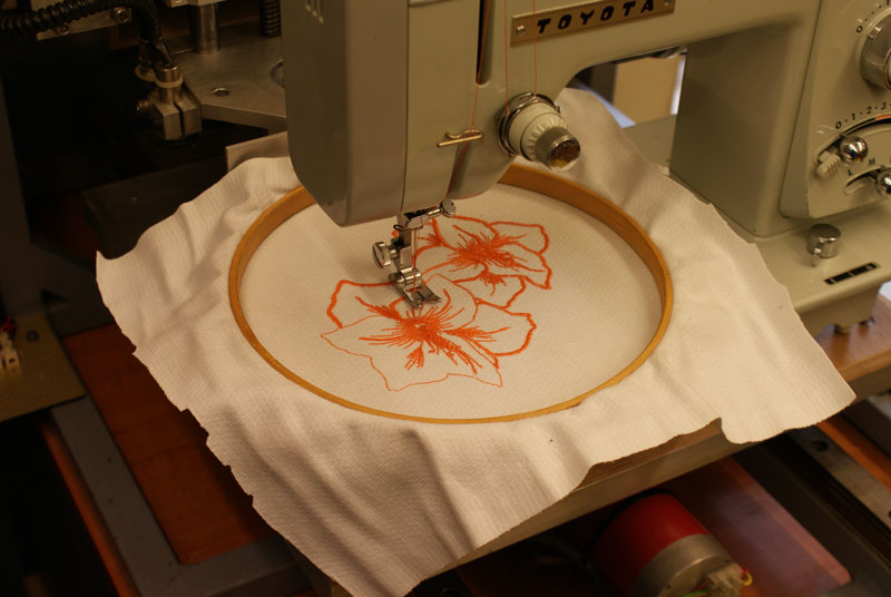

Embroidery machine with XY belt and pinion drive.

    just had another flash of brilliance ...haha ... how about using the z axis as a break ??? Just lifts up to a cam and releases a switch/power to the sewing machine motor ..... z axis doesnt have to be part of the work piece ???? eh ??? lol

    Another interesting idea but I am afraid it may be a little on the slow side with regards to reaction time but thank you for your suggestion - I can never have too much help with this.
    The main shaft will be rotating at >300 RPM and the object is to complete all X -Y movements without ever having to stop the main shaft unless a particular X-Y movement is too great to be completed in the available time. This can all be accomplished easily when software limiting stitch length to <4mm but there will always be exceptions which will cause the problems. :)

    I could not find where to source the Plate (supporting motors/rollers, etc). Is it homemade?
