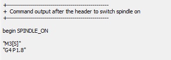

    I'll assume you are referring to some Vectric flavor since you mentioned OB mm. If that's the case, you'll want to edit the processor here
    Change G4 Px to how long you want in seconds.

  9. sharmstr
    2,059
    1,448
    In the pp you posted it says 1.5. The stock PP has 1.8. So just want to confirm that you changed it to P5 and not P1.5.
    Can you also confirm that your M3 command has a S value with it?

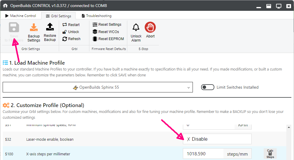

  14. Wendel Clement
    Mar 19, 2023
    91
    Problem solved. It was that $32 was set to 1 enabling Laser which explains why the spindle was also stopping when doing a fast Z travel.

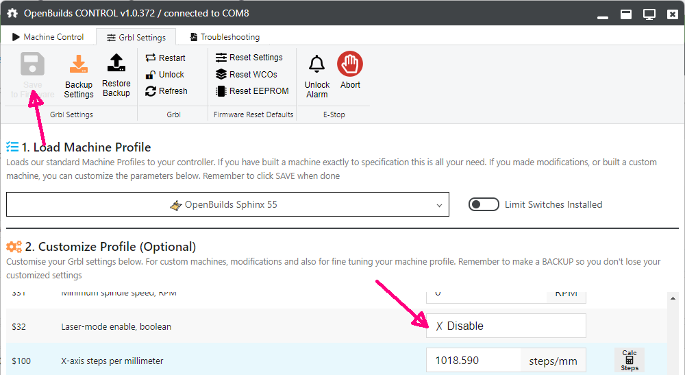

  15. David the swarfer
    3,430
    1,907
    turn off laser mode!
    set laser mode to disabled
    click the save button at top left (it will change color when soemthing needs to be saved
    reset the BB if prompted
  16. Wendel Clement
    Mar 19, 2023
    91
    Thank you for the info. I had already done that and it solved the problem. I did it from the OB c controls app rather than from G-code prompt.
    See above.
