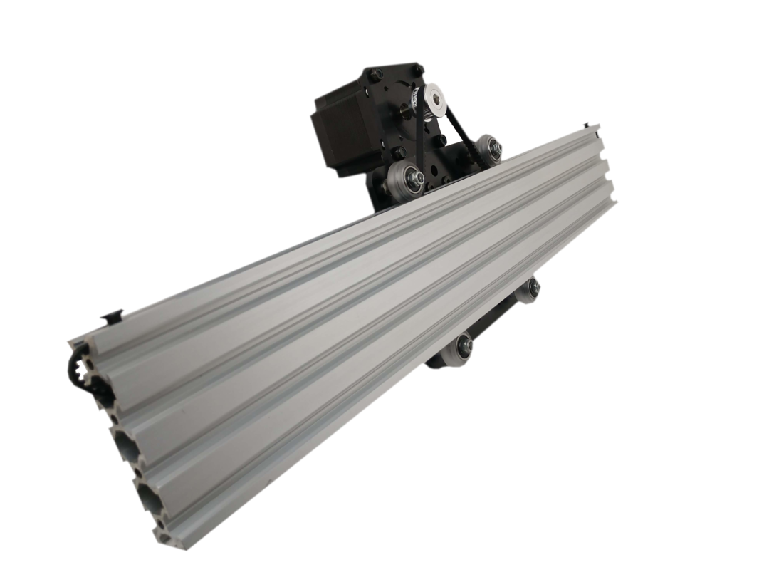

    What type of drive system is Michael using that doesn't require a long v-belt? I am new to this, and would like to copy how he did the drive system. Also, did he make the mounting brackets for mounting the framing rails to the table?

    He is using a belt. It’s a timing belt not a v-belt but a belt just the same.

    Ooh, Is he using the clamps at 4:07 to hold the rubber belt in? Is he using a drive system like this, but I can't see the belt?

    Look at the main piece top center. You can see a big silver drive pulley with a belt coming down both sides. The belt runs down under the rollers and to the ends of the V-slot. Ref: Nema 23 Belt and Pinion Actuator
    Edit: You beat with your response. The answer is yes.
  6. David Devine
    May 1, 2020
    Alright, so he is using the system where the belt is clamped down on the ends? I just couldn't see the belt that well in the video, so I couldn't tell if he used a different system.
