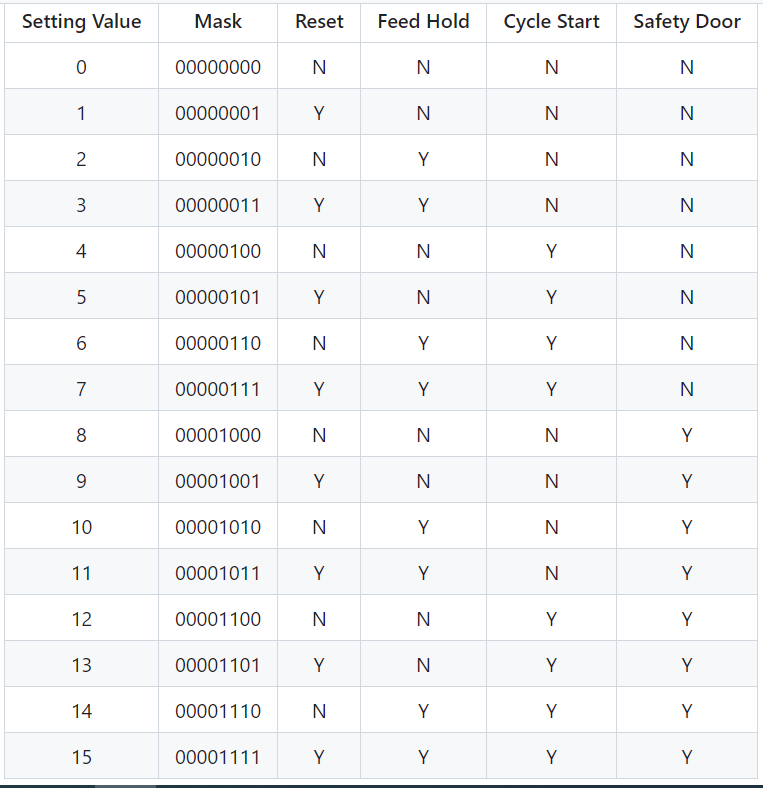

it depends on what controller you have. if blackbox X32 then change setting $17 grblHAL/doc/markdown/settings.md at master · terjeio/grblHAL if an older 4x then you have to recompile GRBL
Thank you! It's a 4x but I do have two of these in operation with an X32 for spare. I'm pretty illiterate when it comes to configuring these. recompile GRBL?
These are GRBL controllers, they run the GRBL firmware (software in the chip inside the controller) which translates Gcode into motor movement. the 4X runs GRBL, the one designed for Arduino Uno R3 compatible hardware (8bit Atmel 328p chip). the X32 runs grblHAL, the (much advanced) one designed for 32bit controllers like the ESP32 in the X32 so, recompiling.... full instructions in the GRBL wiki, you will need to change settings in the config.h to get the pinouts and other things right, and also the invert mask for the door input. much easier to install the X32 and change setting $17 (-: I woudl do that.
Thank you for the information and I have installed the X32. Door input works as NC and stops the motion along with M5 to stop the "tool" plasma. My issue currently is what to set as the $17 mask? 0 - 12? I've tried them all with the intent of having the motion & "tool" stop when triggered. After I replace the breakaway "door" and resume it does not trigger the "tool" only resumes motion. Thanks again for the support! I am well out of my knowledge base, but this is an excellent group for some free education
