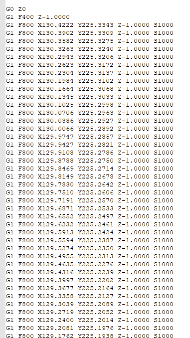

    Is this normal? I have a 1515, and I'm engraving on wood, pretty much using default settings and it is set at 1000 and only cuts at about 25% of that. It just makes for a really long cut. Operator error or is it doing as designed?

    I'll read up on that....but as I am cutting, it's slow, then intermittently it will jump to the programmed setting for a split second, then go back to snail speed.

  9. Rob Taylor
    Rob Taylor Master
    Dec 15, 2013
    1,470
    748
    ...Yup, that's about what I expected to see. Not sure how to fix it off-hand though, it's a CAM arc setting. It's splitting each curve into so many tiny lines they're blocking up grbl's buffer. The "fast" lines are probably longer straight lines.

  10. Peter Van Der Walt
    14,877
    4,285
    OpenBuildsCAM doesn't support Arcs, so, use a more advanced CAM. But per-se "not-an-arc" isn't always the cause though, provided the line segments in the CAD side is sufficient (not too short)
    Always best to clean up a cut file first before loading it into CAM: docs:software:file-errors [OpenBuilds Documentation] - split it into polylines (and smoothed to prevent very tiny segments) in CAD, to make it easier on CAM

  13. Rob Taylor
    Rob Taylor Master
    Dec 15, 2013
    1,470
    748
    You can manually write arcs if you just have the one circle to do- G02 and G03: CNC Circular Interpolation G-Codes - CNC.com - it's a little tricky to get the quadrant points perfect (and the control complains if it's *not* perfect) but it should take your big circle from like, 8000 lines of code to around four and cut the whole thing in like, 30 seconds.
    Nothing wrong with manually writing G-code when you need to, it's still taught that way in introductory classes in a lot of places, I'm sure.
    Long term, yeah, you need another CAM.
