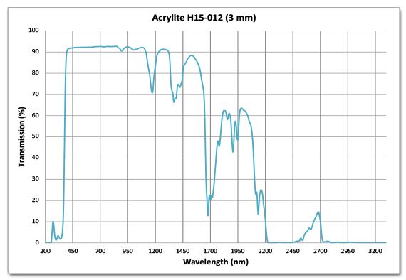

    Wattage isnt the issue. Wavelength is. 405-445nm (blue diode) passes right through clear acrylic.10600um from a CO2 laser gets absorbed by acrylic. You need absorption to heat up the material to effect a cut.
    445nm is great for engraving and light duty cutting on Organics, but not on Plastics

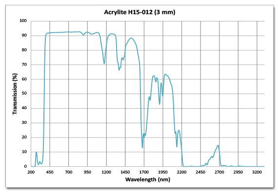

    Transmittance curve for acrylic: (from Transmission Curves of Optics Materials - GS Plastic Optics)
    See how 400-450nm "transmissions" right through the material > 90% just lost going through the material and coming out the back. The tints in colored acrylics absorb "some" energy, but very little. Note at other wavelengths transmission drops to 0% (ie 100% absorbtion). Under infrared (10600um) clear acrylic is almost 100% opaque making CO2 lasers perfect for acrylic and explains their popularity in the signage world

    Your laser sees the clear acrylic as a window and the light passes right through without melting anything. CO2 lasers being on a different wave length see the acrylic as a solid, non-transparent wall which in turn blocks the light beam causing heat to build up where the point of the beam strikes the surface thus causing melting.
