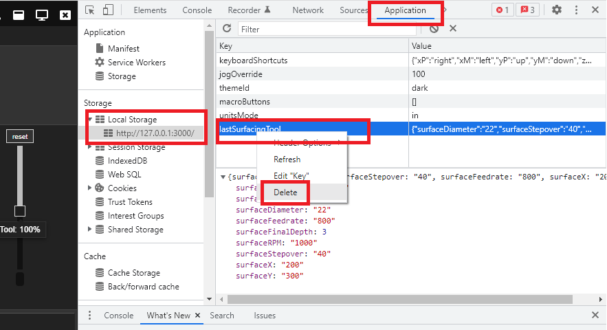

    Just opened the open control software and it downloaded the new update.
    restarted everything and fired up the software. I was curious about the wizard things that was new, but as soon as I click on the "Surfacing / Flattening wizard" the program just freezes.
    installed the latest drivers for my GFX card and looked at windows update for any other update and made the updates available.
    restarted the computer and it still does the same thing.

    The wizard window does not even open up, the program freezes before it even pops up. The dropdown menu is still open and can't get closed again.
    I have tried to reinstall but it didn't help. Even tried to install it on my windows 10 computer and its the same here. So 2 different computers and the same problem.

    Open the Devtools (Ctrl+Shift+i) > watch the Console tab when clicking the menu item - see if theres any errors.
    Could also be that an earlier run of the wizard was ran with invalid data, we save last used values, so that could cause issues. You can clear that from Devtools > Application Tab > Local Storage

    Give that one a go please, does look like something corrupted in local storage.
    Devtools (Ctrl+Shift+i) > Application tab > Local Storage > 127.0.0.1:3000 > Look for the "lastSurfacingTool" key and right-click > delete it. Hit F5 to refresh, then try the menu again.

    Awesome!! This made it work.
    Thanks alot :)

    But if you could do me a favor - copy and paste your key here before you delete it so we can see if we can add improved detection of invalid stored key

    Great. But please guys, next person - before your delete, just copy it out for us to investigate please :)

    Please post a screenshot of Devtools > Application > Local storage > 127.0.0.1 showing all the keys, so we can see
  28. Armaliteguy
    Mar 22, 2023
    Ok ,I was able to get it this time. what I have is.....
    {"surfaceDiameter":"22","surfaceStepover":"40","surfaceFeedrate":"2200","surfaceX":"690","surfaceY":"690","surfaceDepth":"0.1","surfaceRPM":"1000"}
  29. Peter Van Der Walt
    14,870
    4,283
    Thanks, providing this information, has helped indentify the bug, we have it fixed and released as V1.0.364 - see v1.0.364 · OpenBuilds/OpenBuilds-CONTROL@a33135a for the commit log
    It wasn't related to the recent addition of multipass cutting as suspected, but instead to the Coolant option that was added way back in v1.0.339 - so thanks for the help! Without the sample key we'd not have picked up the relation.
    You can either delete the key or update to v1.0.364 to continue working with the wizard
