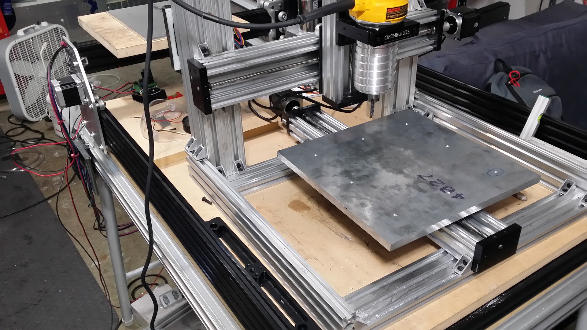

    They are 570 ozin motors from Automation Technologies Inc. Way overkill, but those are what I had in stock from a previous build. Will be powered by a G540 & 48v/7.5A power supply.

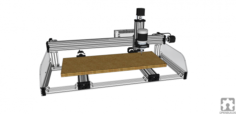

    right but id have to go with 1000mm then right for one of the axis. what would that give me? 12x24
    say i replaced the x axis with 1000mm actuator. left the y alone.
    no that wouldn't work the y would need 2 actuators then?

    Hi Fred....is that SketchUp model avilable online or here etc..??? Thats the mod I would like to go with myself... I recieved my 1st order of parts ok last week, from the OpenBuilds store....I expect to have the $$ at the end of next month to buy the rest of the parts in one go etc FYI Mark....although I do want to source some parts locally here in NZ...supporting local shops...Rgds....Laurie

    Congrats to Tyler for the fast build! And the steppers should handle the water cooled spindle. When I built my first Shapeoko, it was 800x1000mm and I put a 1.5kw water cooled on it. I beefed up the x axis of course, but I ran it for a couple months before deciding to build a super sized Ox that fit the spindle. If I were going to put a water cooled spindle on the "Beam", I think I'd reinforce the gantry a bit. Perhaps bolt another rail to it, anything to cut down on twist. This is one place that the fixed gantry really should shine and handle the weight far better than a Shapeoko or even a Ox.
    I think the Beam is a great machine and I can't wait to build one and will be ordering my kit soon. My only concern with the Beam is the placement of the power supply and controller board. If you are cutting any conductive material or using coolant it seems to me that you are asking for trouble. If the designers are following this I hope they can address my concerns. Anybody running coolant could run a very real shock hazard.

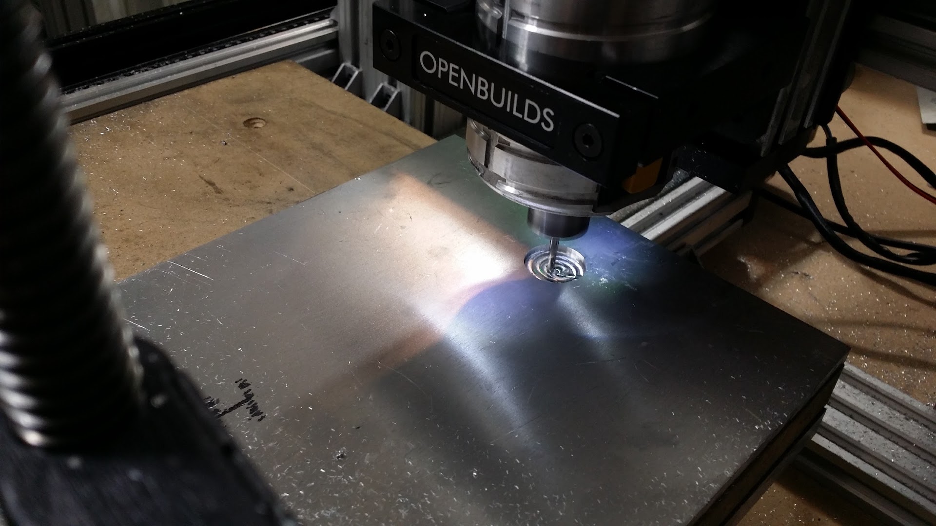

    When you were testing this and cutting aluminum was there any problem with getting chips in the electronics, or did you folks have the controller and power supply in a case?
    I'm just trying to understand your testing procedures and learn a thing or two. OK, I'm just being nosey. :)

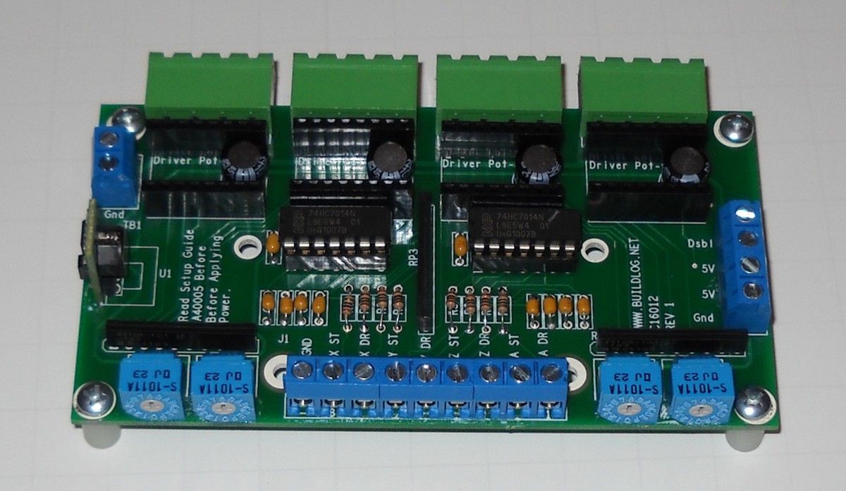

    Here's a wiring diagram for the C10 board and DRV8825 drivers, you could use another break out board, they all mostly do the same thing unless you're spending more money.

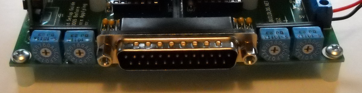

    And if you are buying 8825's, don't forget they plug into the shield with the adjustment screw facing the opposite direction of the 4988's (?). If you put them in the same direction you will burn them out as soon as you apply power.

    Yes, this is important. I snagged a couple pictures and marked it up in....PAINT! See pictures to see the driver direction difference between the A4988 and DRV8825.
    Note: Color and look of driver will vary depending on manufacturer

    Big thumbs up Atomist! This was a hard learned bit of information for me. I cooked two sets of 8825's before I found ONE line about the things that opened my eyes. Oh well. Learn from my mistakes folks. :)

    Cook one set of DRV8825's, shame on them. Cook two, shame on you. Heh, yeah the information isn't readily pointed out anywhere really. Kind of important, kinda. I'm surprised I came across it myself and didn't cook a few sets for dinner.
