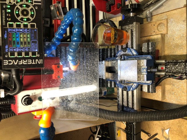

  11. sackindustries
    Feb 22, 2023
    21
    Thank you both!
    @kth heres my mini mill.
    An old CNC Fusion kit. I bought this mill converted to CNC already running mach 3 for cheap. I didn't like how it had this huge control box and a computer running windows XP, so I decided to get something a little more compact for my workspace (hence the blackbox and interface setup). It’s got a brushless motor inspired by this gentleman (www.youtube.com/watch?v=ndhsCeuEv-4). Brackets are custom ones I made and got them laser cut, it's completely bolt in to the belt drive kit from LMS (some parts from LMS). Custom control box 3D printed. Also added a tachometer. Not done yet so the wiring is a bit messy.
