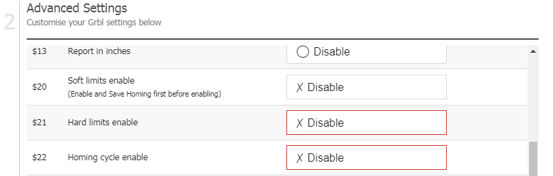

  20. MB460
    MB460 New
    Oct 1, 2019
    18
    So as it turns out, I've seen 2 out of 3 of those videos. The hello world video was one of the first things I watched after assembling the machine. I have not attempted it, because I went straight into using fusion.
    Further updates.
    In the last few hours, I opened the control software, went to settings, and figured out that there was a list of things that popped up in the terminal. No one mentioned this to me.
    I scrolled through and found that $22 can toggle homing on or off. I toggled it off, zero'd the machine to an arbitrary point sans material to work from, so it would run the program in air. I loaded the program and hit go... the machine didn't move, the coordinates didnt change, literally nothing happened. I attempted to run it several times to no avail, so I toggled homing back on.
    I ran a homing cycle once again.
    Told the machine to go to machine home and it took off hauling butt across the table like mentioned several times previously. Nothing changed. FWIW, it went the opposite direction from the limit switches when i hit "go to machine home". Limit stitches are placed in the standard place according to the build videos. Home is towards me, and to my left if facing the spindle. It runs away the opposite direction and has from day 1. All wires are installed as per the build videos, they have been verified 10x over, and the motors all go the correct direction when jogging. Limit switches function correctly.
    Aside from going into the software and selecting which machine I have, I dont know of any pther setup that needs to be done in or out of grbl. Nor do I know how to access it currently.
    I went into grblb settings and cleared all coordinates, and completely reset the software and machine to factory, cleared the eeprom and jogged the machine. 1mm was more like 1.5 inches. I went through the setup, selected the machine in the software and saved settings, moved the machine, and 1mm became .97mm on the Y axis, verified by precision calipers. I didn't bother verifying X or Z. Wife came home with pizza, we ate, I fell asleep on the couch, woke up, took out the trash, pulled the roadster into the garage and started writing this.
    I appreciate the assistance so far, but I'm still not getting anywhere at the moment. The first comment was the most thorough and gave me great info, but I have nothing actionable as of yet. Anything that required research on my end, has been researched and some have given me a better understanding, at least well enough to use more correct terms to explain my issues, but many of these things are things which I have done already and have not rectified the situation(s). I am without a doubt clicking the zero button to set to work area zero, and a homing cycle should set home on the machine but doesnt. I usually home the machine FIRST, then zero the spindletobthebworkbarea. I am zeroing itbwas accurately as possible without having a probe or plate.
    What else is there?
    Using a less advanced software would only prolong my ability to do what I need to do and would lengthen my learning curve for ultimately using this software. I'm not having issues with the software itself aside from maybe not setting my retract and feed heights correctly and hitting the limit on thick stock, but that is usually an obvious issue which I tweak and re-gen the code.
    But these same issues appear even with thin stock. I tried to engrave a piece of 0.020 brass the other day and had the same issue. I broke 3 engraving bits from the machine trying to bury itself, and then cut 3mm above the work area (which as ive said is the case regardless of what I'm trying to run. It does this on every program I run. )
    Anyone else have ideas? I have seem similar threads to this and it seems that no one had an answer on those threads either. The OP's gave up on them before finding a resolution, or found one on their own and never posted the fix. What do I need to provide to this thread that would help find a resolution?
    I REALLY do appreciate the help and the time you guys are taking to answer. It's just aggravating, because it's been several weeks and close to 2 grand and i cant get this machine to do anything. I do have much more time to dedicate to this than a lot of people since I work from home. But I'm getting impatient and aggravated with this issue.
    Maybe I'll try the hello world tutorial tomorrow and see if it runs correctly. Since everything is pre-made, it should... right? And if it doesn't, then there's obviously something wrong.
    Could it be something with the black box itself?
    Thanks again

    So, lets remove some things and get down to basics:
    please do this
    1 - go to the GRBL settings and turn off homing and turn off limits
    $22=0 ; homing off
    $21=0 ; hard limits off
    $20=0 ; soft limits off

    David's a genius when it comes to explaining coordinates/homing and such. Glad you made some progress.
    However, location of homing switches are a personal preference. I prefer to have them in the lower left for several reasons. First, that's where I stand when I start the job. Having a limit switch within reach is an easy way to stop the machine if I forget to set my work zero (happens a lot). Second, like you, I have a 1510. Since I stand near the lower left, most of my jobs, tool changes and checking the X gantry for square (If you are still running belts, you'll want to do this often), happens there. Having homing go all the way back takes too long. Third, instead of using the jog buttons, I send a lot of commands via serial. Its easier to send positive commands after homing than it is to send negative commands.
    There's no wrong location for homing. Just understand that G53 X0Y0 is your machine 0. If your x and y switches are in positive locations (upper right, $23 set to 00000000) then homing will set your machine 0 to your switch locations. If like me (and 1,000s others with OB machines) have your switches in the negative locations (lower left, $23 set to 00000011) then homing will calculate your machine 0 by using the values you have set in $130 and $131. i.e. If $130 is set to 990, machine 0 will be 990mm from your switch.
    While its important to understand all of that, the only time I ever use G53 is to retract Z at the end of a job. I never use it for X or Y moves. And I've never had a need to send the machine to Alaska :)
    David the swarfer and MB460 like this.
  26. David the swarfer
    3,430
    1,907
    looking good!
    bits are seldom the size stated on the box, measure them then tell Fusion the exact size.
    also, when calibrating you must calibrate over the longest distance possible for the axis. I use a 500mm steel rule and an engraving V-bit and am very careful about parallax errors.
    Though the wizard in OpenbuildsCONTROL does all the math for you, you do need to know the proper process HOWTO Calibrate your CNC Machine for MACH3 or GRBL
    what we have 'fixed' is removing the homing switches from the mix. AND I think we have established where the setup WCS 0,0,0 are in Fusion and how that relates to setting up the machine.
    With limit switches off and homing off you cannot enable soft limits either.
    My machine has neither home nor limit switches. Up to me to engage brain and make sure my part is placed correctly (for big ones, small ones are seldom an issue) and that I have set zero properly. One part of doing this is clicking the 'check size' button which will traverse the tool around the outline of the part you have loaded. A very useful crosscheck, and let it crash now instead of while cutting <-:
    This is exactly the correct process, build knowledge with a known working system. We are climbing 2 mountains at the same time, 1 = operating the machine, 2 = operating Fusion360 to get code that suites the machine. Climbing the 'make homing work' at the same time is not the best idea.
    On the subject of positioning for tool changes, you don't normally do that at 'home'. On my machine this is far away against the wall! But this is what the gcode G28 is for. manually home as usual (technically, once you have done this and remember to park it there (that macro button I mentioned) before turning off, you don't really need to do anything but turn on) then
    1 - jog to where you want to change tools (Z HIGH, right?!)
    2 - go to the 'serial console'
    3 - enter G28.1 and press enter
    now GRBL has stored the current position and you can go there anytime by issuing a G28. Make a macro button for it (-:
    Using G28 hinges on always having home in the same place, whether you have home switches or do a manual home like I described does not matter, just so long as it is always the same as it was when you set up the G28 position. This is because GRBL stores offsets from the MCS for G28, so if the MCS changes so will the G28 position.
