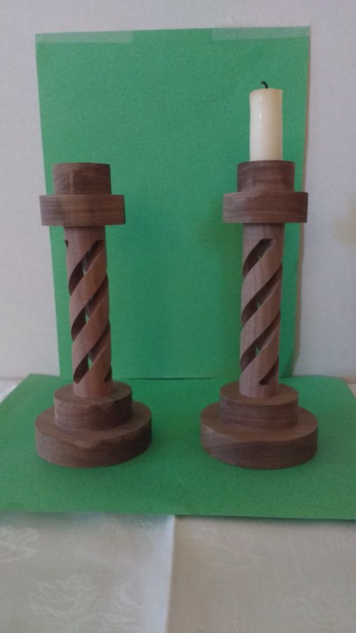

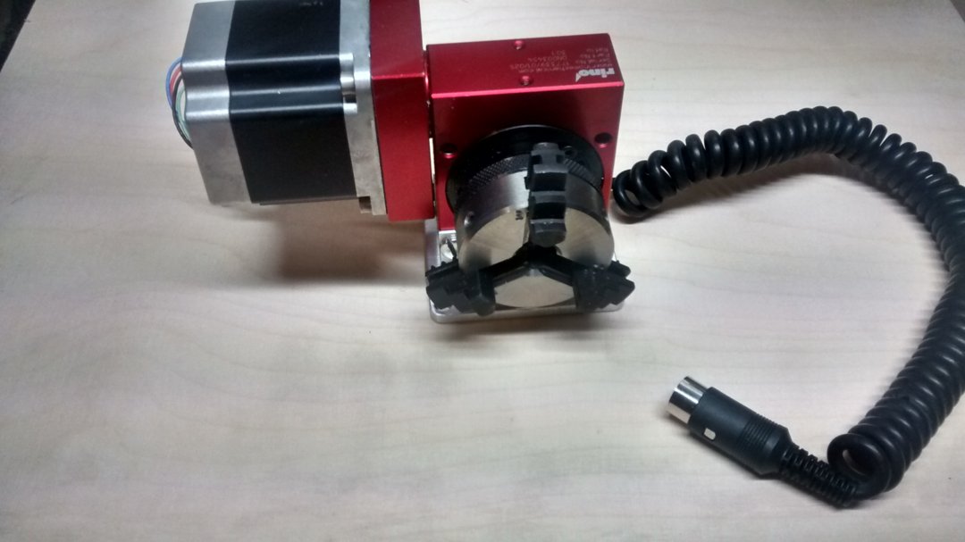

  11. Gabriel Faber
    Mar 5, 2014
    17
    31
    I combined (needs custom axle) a Rino Ondrives worm stepper with a 2" chuck from Harbor Freight to create a light duty 4th axis. It's controlled by Mach 3 IMG_20151102_195456504_HDR.jpg
    I cut these candle holders with it on my (Tall) OX
  12. GrayUK
    Good looking jobs. :thumbsup:
    Mind you those Rino Ondrives worm steppers are not cheap. :(
    I'll have to start saving my pennies. :D
  13. Gabriel Faber
    Mar 5, 2014
    17
    31
    I got mine for $62.50 on ebay (2015)
  14. Anthony Bolgar
    Anthony Bolgar Journeyman
    Jan 14, 2016
    354
    198
    They are now $250+ onb ebay
